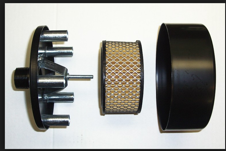

Another thing you may want to do is cap the mufflers with an air filter. Will help to quiet the in rush. Filter housing.png
We used all different sized units like pictured.
Kept small particles and other flotsam out of the works and ultimately off the web.
Another option(inlet side) would be to use an air box(air cleaner holder) from a car or small truck. They are designed from the factory to quiet the incoming air stream.
Or you could always put a K&N style(non-oiled mesh though) on the end of the muffler.
Link for pictured filter housing: http://www.aircompressorpartsonline...56av-air-filter-housing-welement-p-21162.html
Would have to make sure you have an adequate CFM rating though. I didn't check the one pictured.
