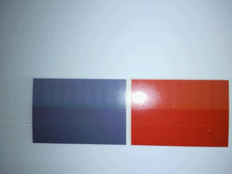

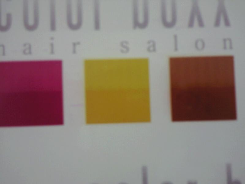

Hello everyone,
was wondering if anyone would be kind enough to pass along their wisdom on this problem I am having with my 1204. I think I have tried just about everything I can think of or have heard of.
Have tried these fixes so far but has not worked:
1 cleaned encoder strip
2 messed with PF adjust
3 different heat settings
and other things as well
As you can see in the pics every thing starrts out perfectly, but after traveling about a half inch every thing starts banding.
Any advice on this would be GREATLY appreciated.
thanks

Thanks Malkin, it seems that way to me too, but why would it lay down plenty of ink for a half inch and then just stop laying down that same amount from there on?

the fade/starvation... is it universal? put together a file: a square of cyan, magenta, yellow, and black. to see which actual color/s is dropping. also, do a damper swap with failing colors over to print head positions that are not failing. that will tell you if the issue remains at the failing head (cap/head issue) or follows the damper (damper, line, cartridge issue).

so, it's every color dropping out equally? you can diagnose bad cap seals by damper swaps (if some colors work while others don't). or...
