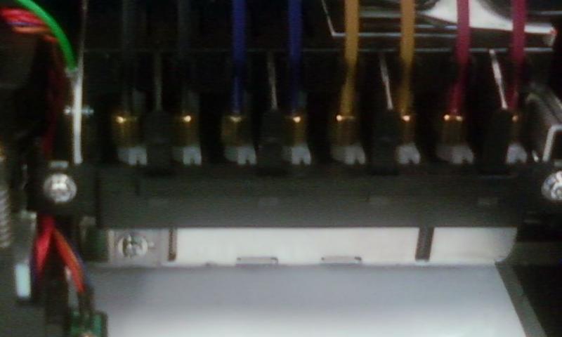

Thanks again Artbot... Wiuld you say that bottom of the head (where the ink sprays out) should sit absolutely flush level and not be tilted whatsoever?
Cause when I look at the head it is definitly tilted. And so happens that the side of the head that sits the lowest is the side with the black ink head.
So that side is probably completely capping but he other side is not whic would explain the problems with those 3 colors... Does that make since to you Artbot?

Stealth Ryder
"Find out where air is getting into the system and correct it"
There's your problem, re-seat the Head (correctly) in the CR Assy..

Stealth Ryder
You can visualy see if the Print Head is level by observing (tilt up left-tilt up right) it's position while it is out to the left in refference to the Platen... This is very easy to spot if looking for it but overlooked by many who do not know to check for... It is very easy to seat the Head incorrectly, heck I have done it myself while rushed back in the day... I have since learned to check prior to re-assembly of all the residual parts... This pic will not show the correct angle to observe from but look at the "silver" band around the actual print head, if slanted you will see in relationship to the Platen.
