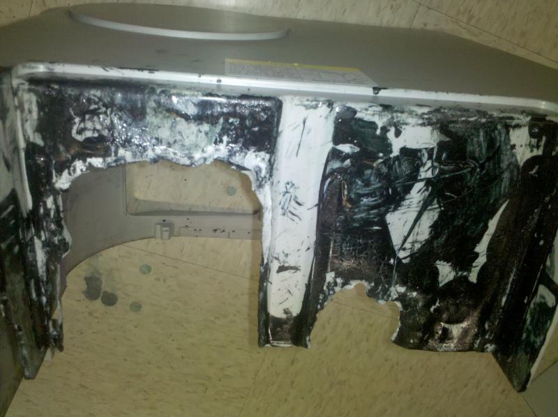

This is probably caused by ink getting onto the plastic cover that is above the waste box. When enough of the solvent ink gets on this plastic it starts to melt it. I have seen this before at one of our customers and I have attached a picture of what it did. You can see in the image that the plastic has completely dissolved.

it seems strange that the hulls of these solvent resistant printers are not solvent resistant. that is nasty!

I realize this post is 7 years old but I just encountered the same issue, it did not completely get dissolved, but started to melt. I searched for that part (the whole outer panel) and couldn't find it anywhere. Would you now by any chance what could be done to save our printer?

It's not worth it to change the cover. I priced one out the other day for a customer and it was around $250. Just cut off any plastic that may be getting in the way of reinstalling the tray and forget about it.

Thank you for your responses everyone, I ended up taking the tray out and fully drying everything. It seems to go in fine, it's kind of tough to pull it out. but everything works. I've spoken to signwarehouse, they said I could order the whole panel for $69, part # is DE-12552 if anyone ever needs one. I will probably order one just on case it gets worse
