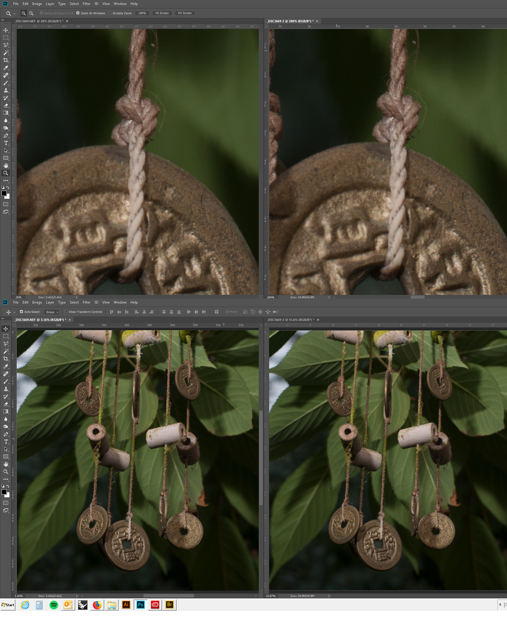

If your image is RGB there are some pretty powerful new features in Photoshop.
The "camera raw" plug-in in has some pretty nice noise tools. If you are too heavy handed you can get to a painterly effect.
Ideally raw files from the camera would be best. It's less the dpi and more the image you are starting from.
jpegs from camera are great, until you need double the resolution.
A .psd export from the raw file will give you the least amount of artifacts. Period.
"Preserve details 2.0" in the latest CC version blew my mind.
It's really pretty good.
This is a raw file from my Nikon D90. Not full frame and maybe 12 megapixel.
This is from my native 4288px x 2848px file. I went to 42,880px x 28,480px in one step just to see.
The rulers in the image say it all.
