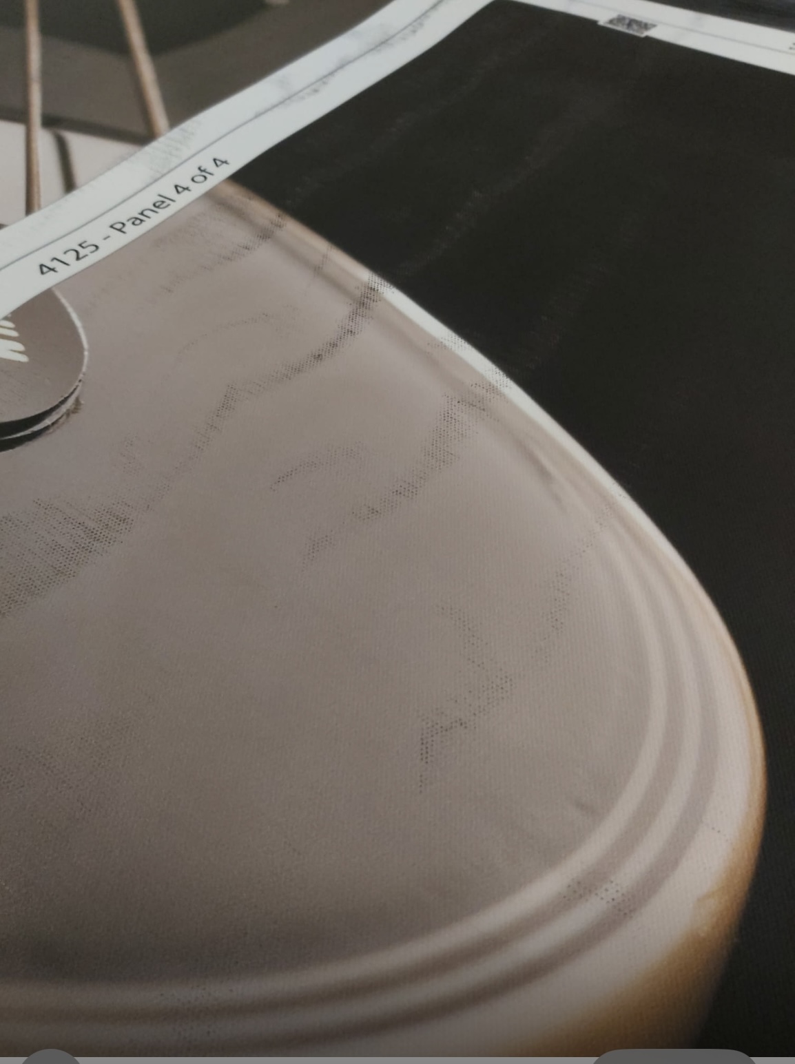

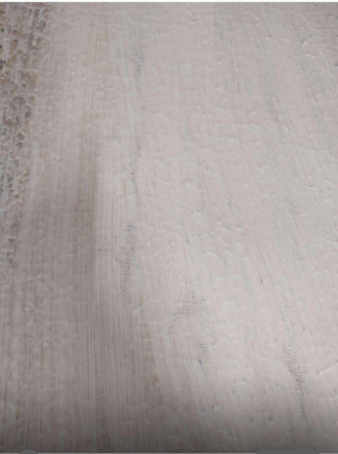

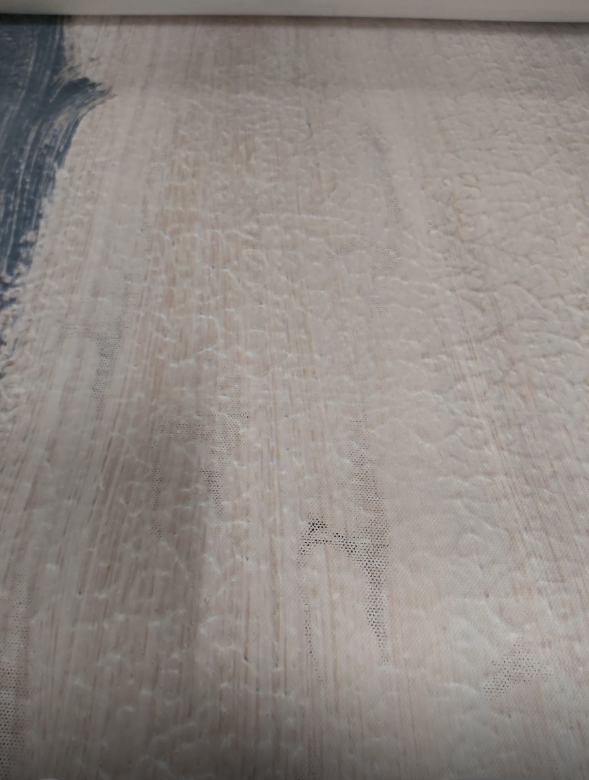

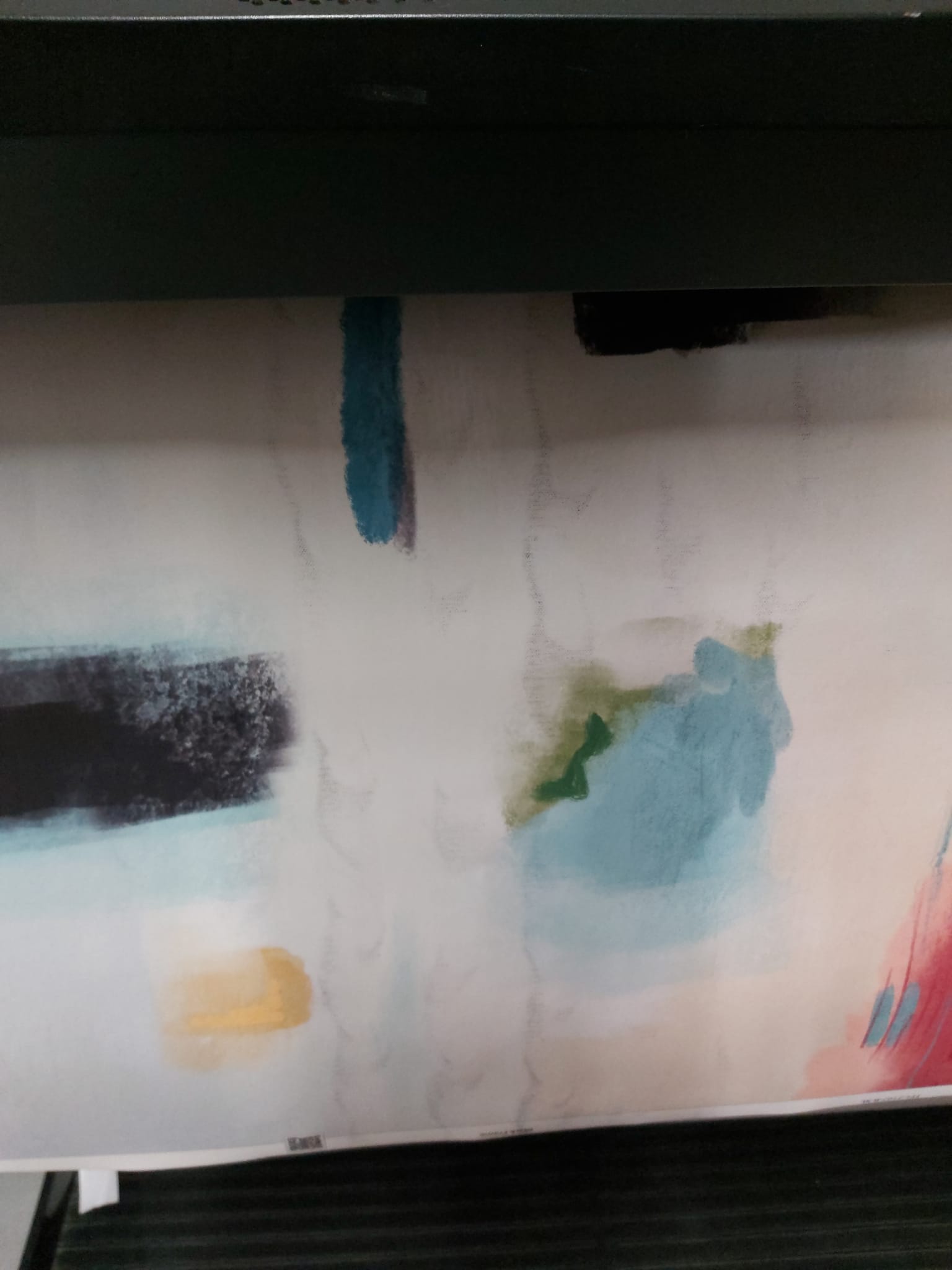

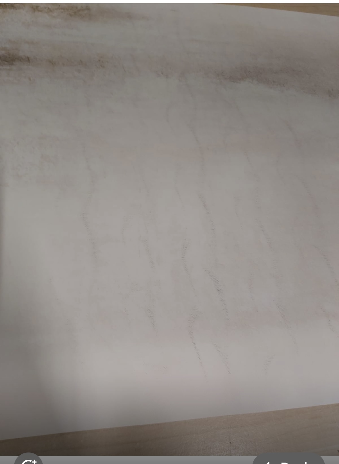

Hi Guys,
Hope you can help please.
We run the same media on all of our HP Latex printers ( canvas media )
On one of our machines, we have had black vein like marks traversing vertically through the prints, in an uneven fashion. Like a squggly vertical vein.
I have attached a couple of pictures, not sure how clear it is to see.
But it is black vein like pattern which is ruing the prints.
We have swapped rolls, and it is not the roll.
It looks almost like the media is puckering as it comes through the rollers.
https://www.dropbox.com/scl/fi/nk41...ey=tz4zyehhcyapvrkycaez2kh2o&st=zhxs4lwa&dl=0
Nothing has changed, no settings, no new parts, same media
It almost looks like the print head is catching on the print, and the print is cockling
No heat settings changed
Puzzled to what it may be ?
Any words of wisdom massively appreciated
thanks in advance
kind regards
Jack
J4cko
Jack
It looks too distributed for that to be the case ? and it looks clean as it comes through the rollers, and if we feed media through, there is no marks
J4cko
Jack
i have just been informed that on the pinch rollers ( the one on the right hand edge, by where the carriage returns to ) , as been replaced yesterday. Nobody knows where the old / missing pink roller from the far right hand side is ? Could it be that the new pinch roller is causing this puckering of the media ? and/or that the old pinch roller is stuck somewhere inside ?

Turn it off. Pull out the maintenance cartridge. Inspect and clean the bottom.
Now important. Move the carriage leftwards to the middle. Push the cartridge back in and start the printer.
J4cko
Jack
Thanks Balstestrat, much appreciated. What would you suggest using to clean the underneath of the carriage ? ( apologies for any naivety )
