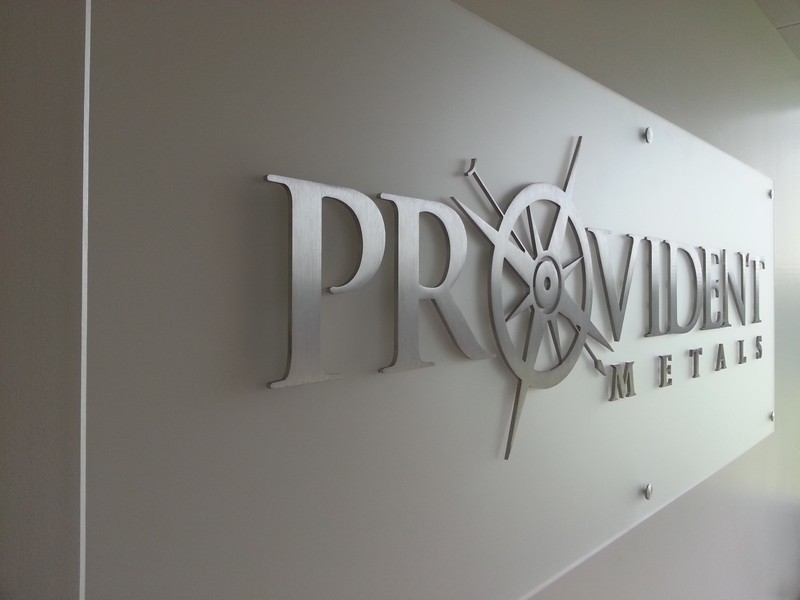

Is this the look you want? Try using non-glare acrylic - it has that matte look that you are describing, especially when using stand-offs.

Precision Sign Services
Yep, P95 is a matte that can be frosted or colored. The picture below is a P95 panel I put together and installed a few weeks ago.

I think that Plexiglass, brand name, uses that P95 labeling as their frosted, OptixNG, non glare, is the brand that is also good.
