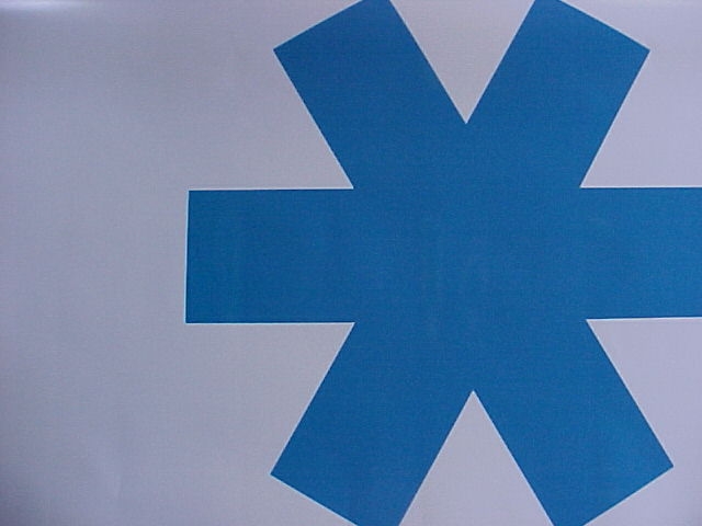

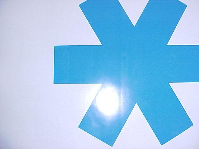

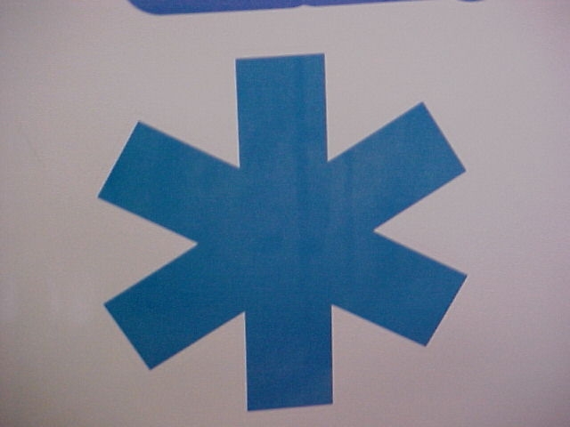

    sol pictures
    hi,
    not sure if I have these attachments or not.
    I was using roland esm calendered gloss
    Using ecomax inks
    Using profile in versaworks: GCVP: ESM
    Picture 3 has the flash on, but just to the right of the flash you can see the "streaks" I was talking about.
    Thanks,
    Tim

  13. Barry
    Barry Active Member
    659
    May 6, 2004
    Honestly that looks like a media problem to me. I would pick up a roll of Oracal 3651 and I bet that will solve your problem. Some or Rolands media is known to give inconsistant results.
    PS, normally banding caused by the printer or profile is very consistant, media problems are usually all over the place.
