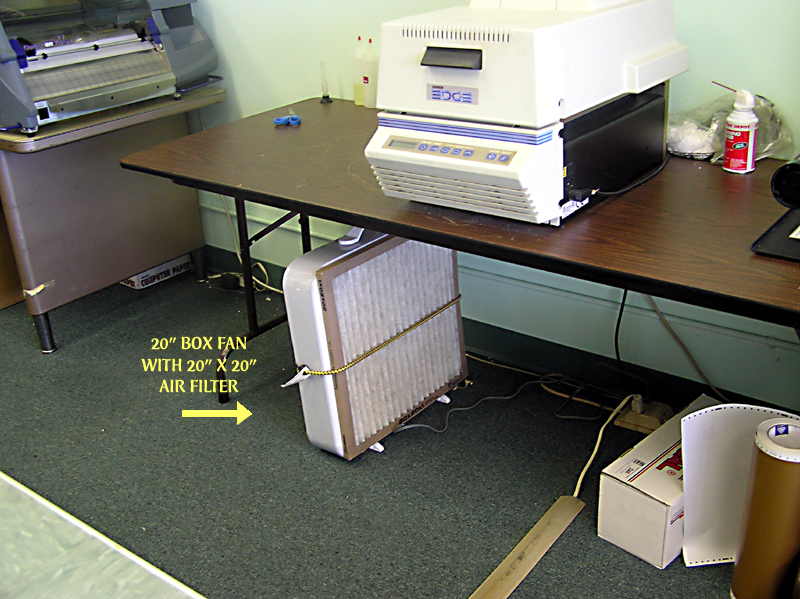

    You might want to consider buying some box fans and air filters to reduce the problem. I've had three setups as shown in the picture running 24/7 for several years now and have almost zero problem with dust.
    The fans are about $15 at Home Depot and the filters are about 3 for $8. We change the filters once a month.

    What a great idea, Fred!
    :thumb:

    :cool1:
    Great idea, thats just what I needed. I'll be setting up two of those up tomorrow.
