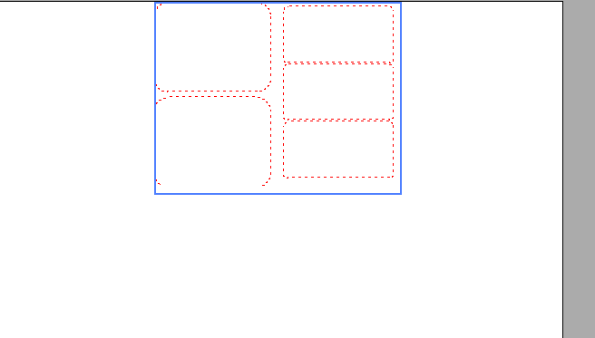

    I sometimes see Versaworks clips files with cutlines if they are saved as EPS ( see screenshot ). If they're saved as PDF's no issue.
    I've read about the EPS margin setting, however it's grayed out ( I don't have an integrated print / cut printer ).
    Saving as a PDF is fine, but I'd like to know what the "real" issue is.

    You need to go to Edit, Que Settings, and then you can adjust the margin by clicking on the file format tab.

    can't adjust settings
    That's the issue - it's grayed out, can't change it from 0.

    Yes -- but I figured it out. I didn't think it mattered what file might be highlighted if I was setting the queue settings - but it does. If a PDF was highlighted, I couldn't change EPS margin for the Q. Selected an EPS and then I could!
