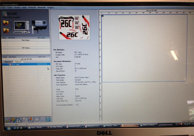

    Hi, i have been using Versaworks for around 6 years,
    Last week it crashed and took an age to restart because it was taking around 5 seconds to load each job on the start up screen.
    When it came back on the images were missing from the layout window. It just had blank boxes for each job with the que a / que b in the top left hand corner.
    I deleted versaworks and re installed and updated but it was still the same.
    Anybody had this problem before? Or any suggestions?
    Steve

    are your files hosted on a network drive? sometimes our network connection flakes out ans something similar happens.

    I have run into this before. Initialize application did not work in my case either. I had to do a complete uninstall of Versaworks using remove programs in control panel. Double check that there is no folder or files left in the program location. Also, check that there is no versaworks folder or files under C:\Users\"UserName"\AppData. Reboot and reinstall Versaworks.

    Uninstalled again, re installed version 2.61
    i had the preview back but the version needs updating.
    Updated and back to no preview on the layout image.
    GRRRRRRRRR

    Only fix i found for this is to do a complete re install of versaworks.
    This happened to me again on a completely different laptop about 12 months after i fixed it and i had to re install again.
    2nd time this has happened to me now.
