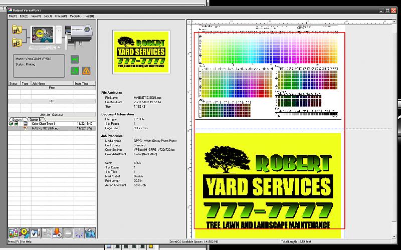

    Hi guys,
    I've been using VersaWorks for few months now and alway wanted to ask this question, no really a big problem but bothers me sometimes. The VersaWorks I am using is version 2.4.2. Look at the image I attached you'll notice that the designs in the layout window on the right looks like they're pixelated. The prints come out fine. It's just the preview image doesn't look smooth like it should be. The program is running on one of my dual-monitors set up. I am not sure if it has caused this problem. Does this happen to you too?
    Please take a look at the picture.
    edit: You can't really notice anything in the attached image I just realize that image was resized. Here is the link to full size image. And make sure you view it in full size in the browser.
    thanks!

    Edit>Preferences> Preview...mine is set on standard. If you change it to high quality it might make your image look better but it will probobly use more memory to do so.

    mine does have the image like that too, but the prints always print out just fine

    Mine is the same, I believe it is because Versaworks recommended monitor display setting (resolution) be 1,280 x 1,024 or higher, my monitors are set at 1,152 x 864 and I have not tried a higher setting to see if that would resolve the issue, think I'd need to go get stronger reading glasses if I were to increase the display resolution.

    Ours does relatively the same thing, but what does it matter ?? That's only a representation of what you're printing... like a thumbnail. You should already know what it will look like from whatever software you created it.

    Mine is already in high quality mode and it won't change anything.
    Now I know it's not my problem it won't bother me anymore.

    I cared at first, but then I lowered it to the lowest possible preview quality cause it doesn't really matter. I'd rather save the processing(however little it is) for ripping. =)

    If you are like me you have flexi, illustrator, versa works and a couple other things most likely all running at the same time. So mine is set to the lowest quality.
