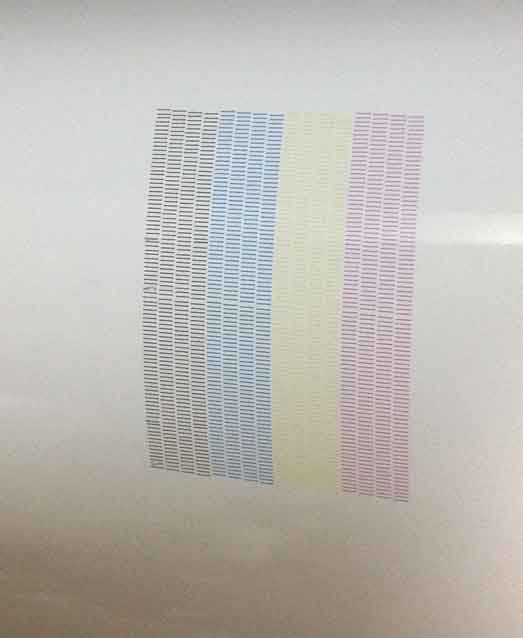

I have a Problem , attached you will find Pictures of the Issue, I use the ROLAND SP-540V and VersaWorks 4.4.0, on a regular Test Print from the Machine seems to be everything fine (see Picture TestPrint_16-04-2015) When I send a colored Picture Print everything what should be blue comes out in green (please see your Logo on the TestPrint_16-04-2015_1) and then everything what should be yellow comes out pink (redish) (Please compare Untachable with Print_16-04-2015). My first thought was it is a Software Issue but I was sending a Print from FlexiSign 8.0 from a other Computer and the same effect came out.
I called our technician in Florida and get the answer "If the Roland test print looks good the machine is fine. It is your work flow and file preparation." I really tried everything and need help...urgent!

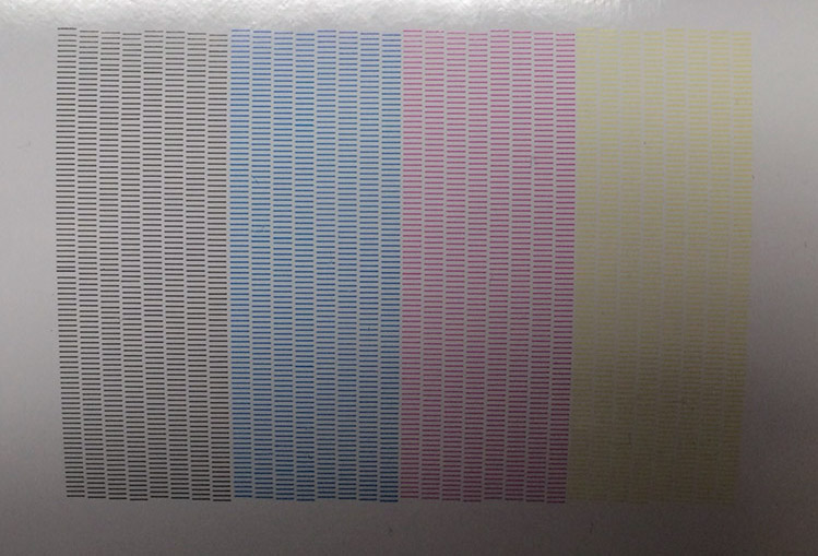

It appears that the Yellow and Magenta inks have been reversed in head #2. On the SP machine, there are two heads, and head #1 should be firing KC and #2 MY in that order. Your #2 head is firing YM.
See the attached nozzle test print (from a VP model).

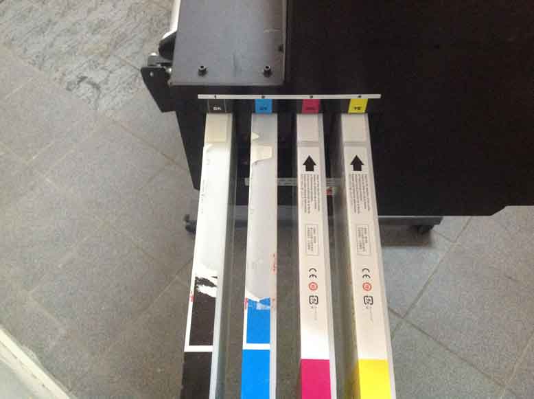

MaxiJamaica
I just realize that Magenta and Yellow is switched... but the Ink is in the right place!
And what you think I should do?
The proper answer is to find the place where the colors were swapped, and reverse them. More than likely, reversing the two lines/dampers on head #2, and then running a number of cleanings (or better yet, syringing from below the captop) will eventually clear out the contamination from the head.
