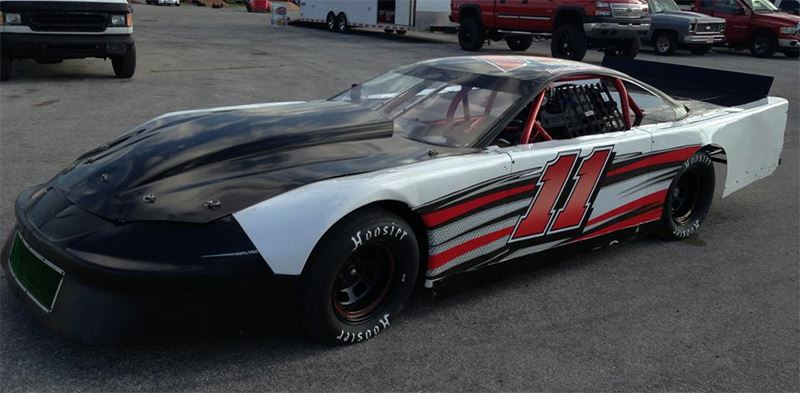

I just received a Valuejet 1204 and a Enduralam laminator.. we specialize in racing graphics and print wraps like this one attached.
We are currently using the Arlon GTX 4560 and Oracal 210 Laminate.. Does any one know if this combination will work good on flat surfaces?
Also, what do you think the max ink cost would be per sqft? I'm brand new the printing part of signs and that was the first wrap I've ever printed...
Thanks guys!
**Edit: At most these wraps will last 6 months before getting destroyed

Pretty much anything will work on flat surfaces and as far as holding up it really doesn't matter on round track cars. One thing to watch for is the area around the exhaust pipe if it comes out of the door like most around here. The heat will cause the vinyl to distort and sometime change color. Also if you do any hoods that have deep body lines, the heat from the engine will most likely cause lifting in those areas. BTW the car looks good, keep it up & make sure you charge enough & GET PAID.
