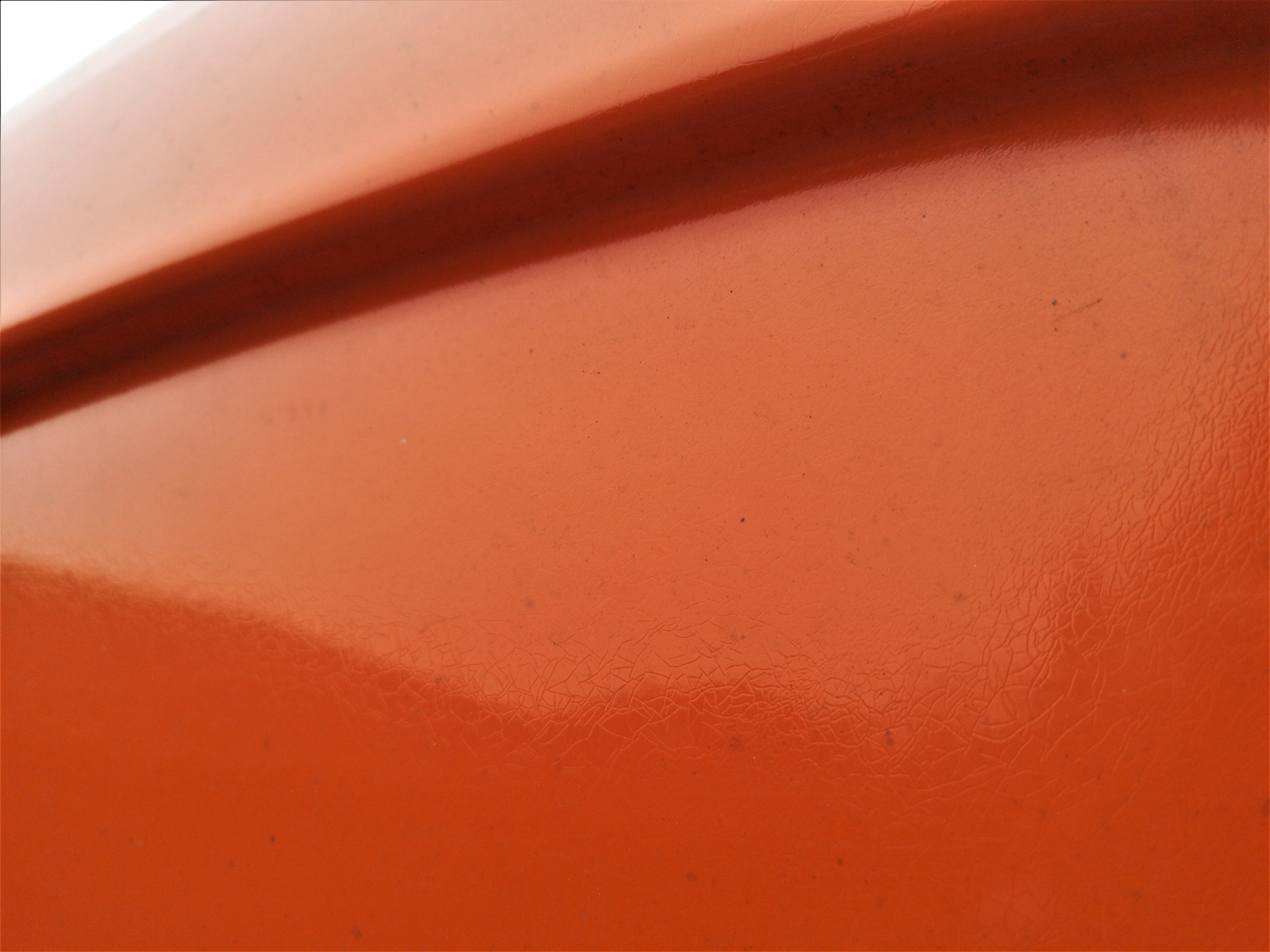

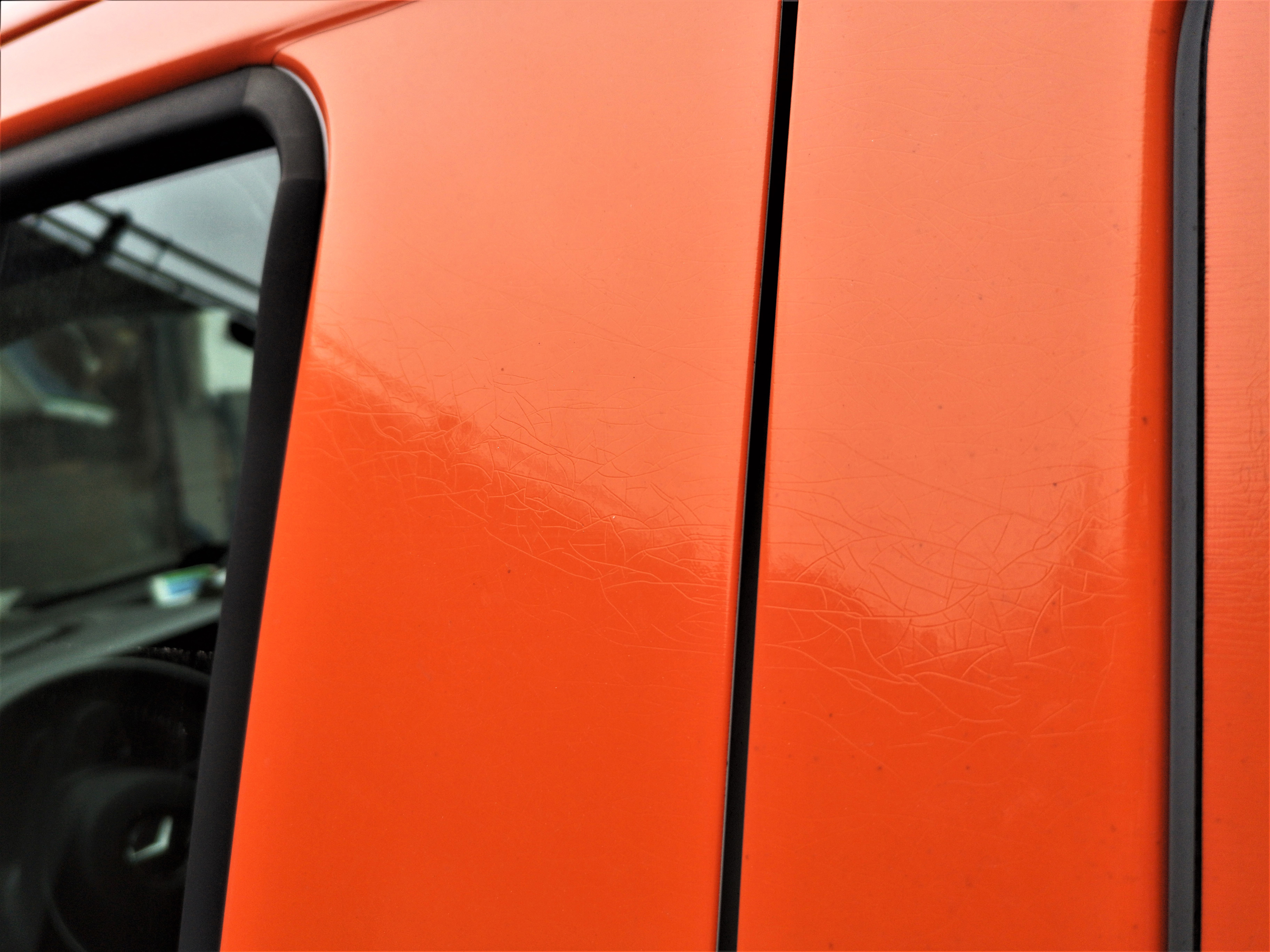

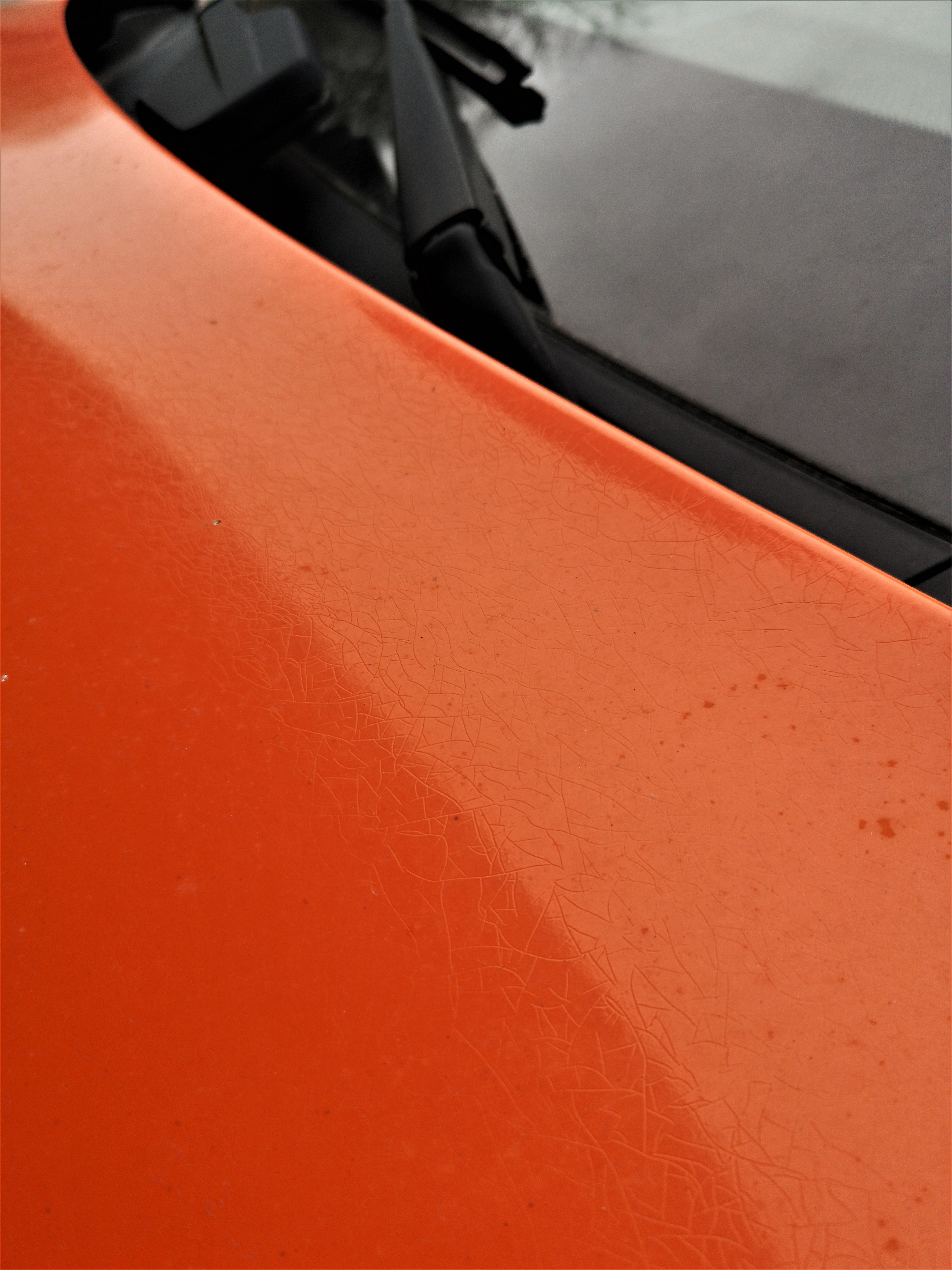

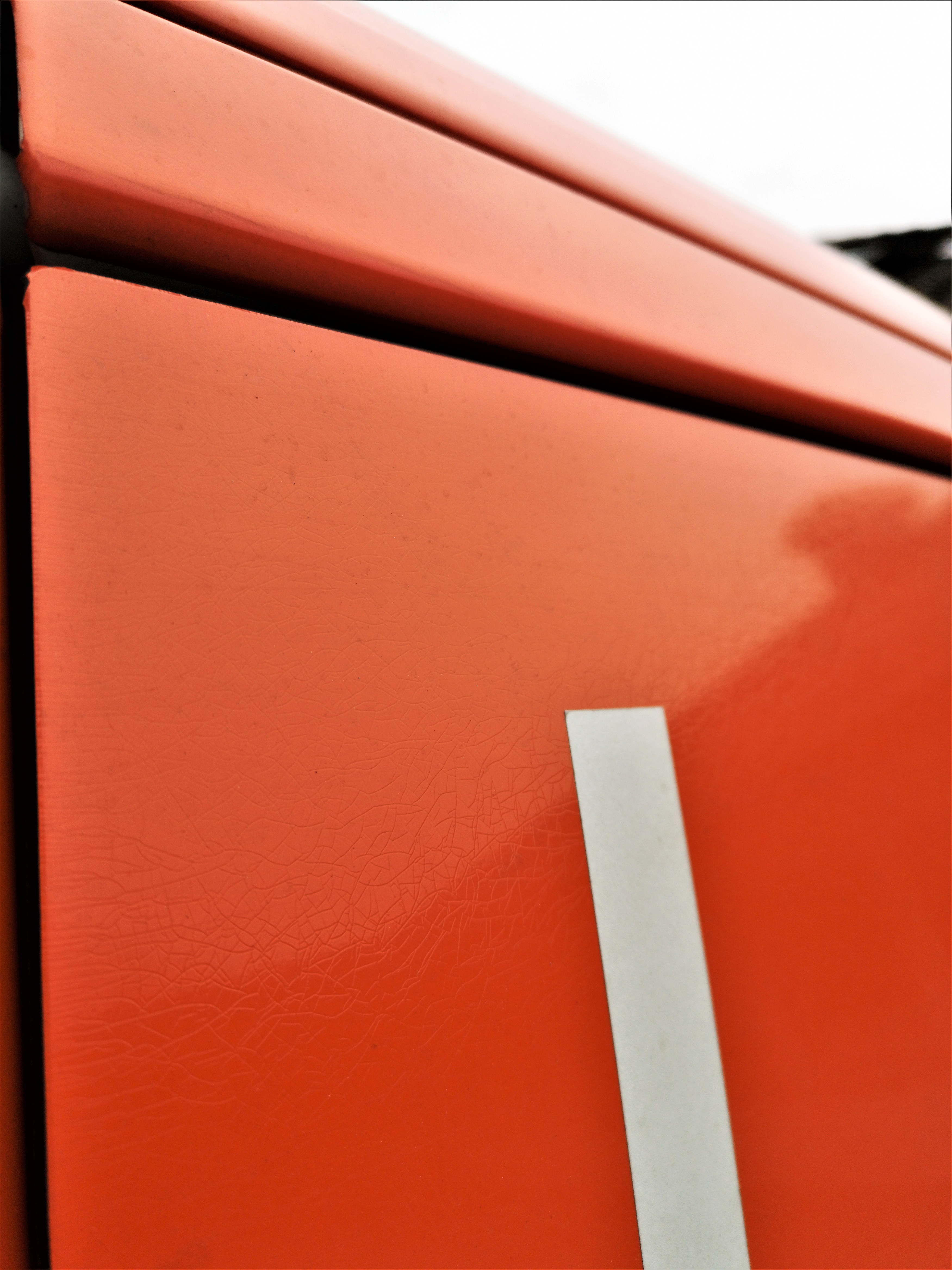

A customer of ours came in with his 2 vans we wrapped about 4 years ago with Avery SWF Orange. The WHOLE van's vinyl is crackled ( looks like a dried-up lake) regardless whether it's the roof, bonnet or wheel arches. See attached.
Never seen this before. Anyone have any ideas/theories?
Otherwise the actual wrapping is as it was delivered with no signs of loosening or fading.
Cheers
Ian

Wow, for Norway that's not great. Avery claim 10 year vertical and 5 year horizontal on plain coloured SWF for that warranty zone.
PS Reklame
Yes, but our Avery supplier will say the vinyl was treated with some sort of cleaning solution so I need to know if anyone has any experience with this and what the cause was.
