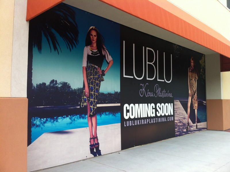

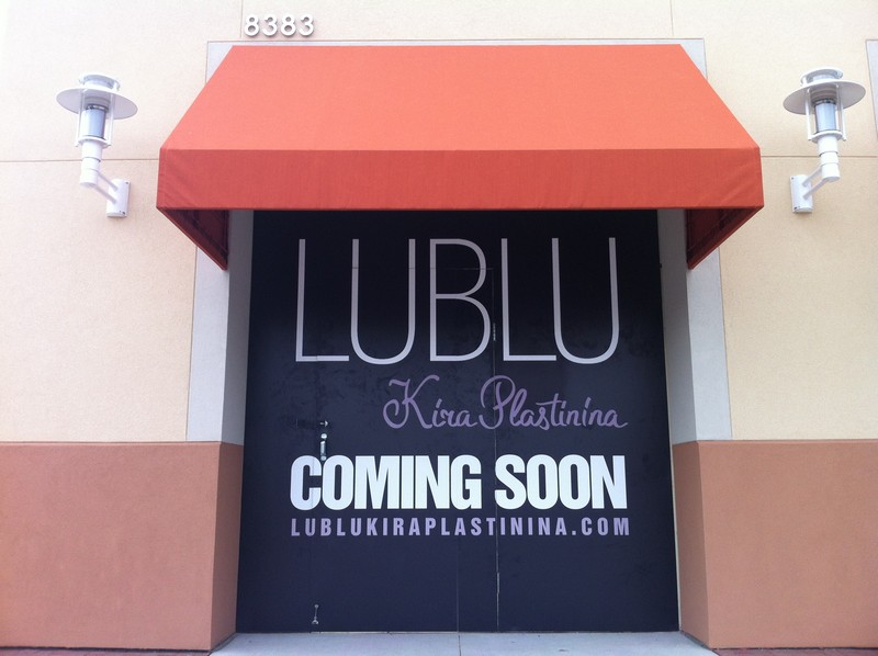

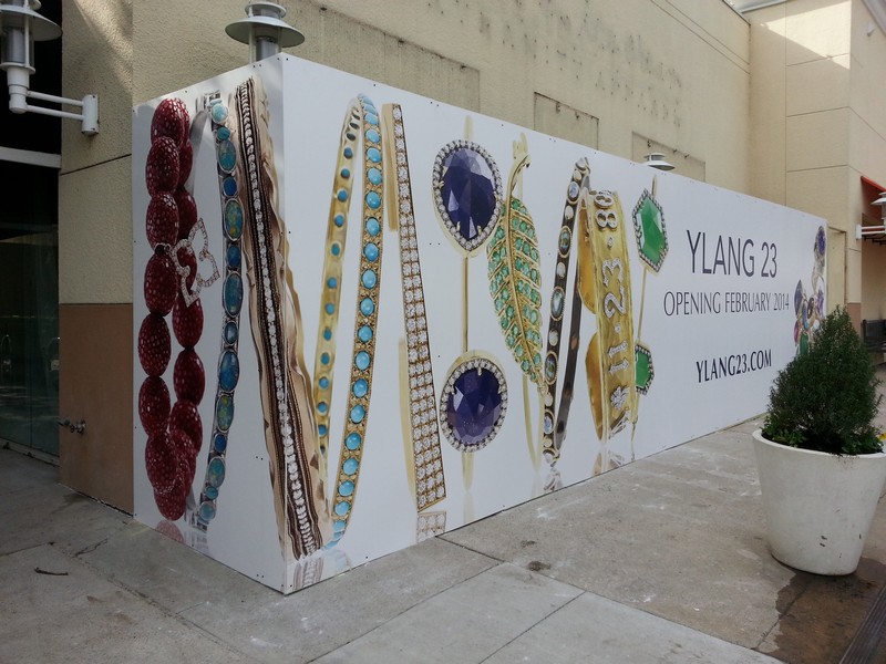

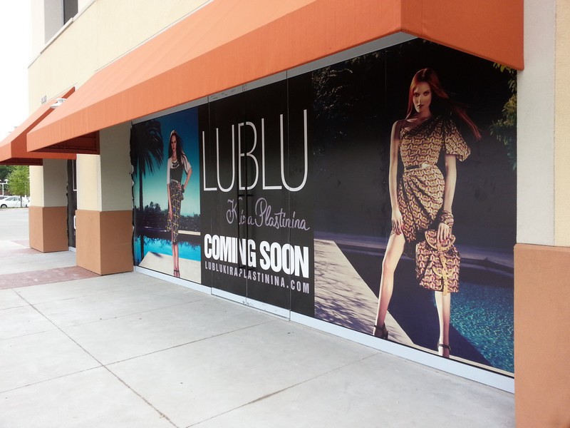

Is printing an option? Printed Sintra goes up a whole lot quicker than vinyl.
These are some recent ones I installed...
