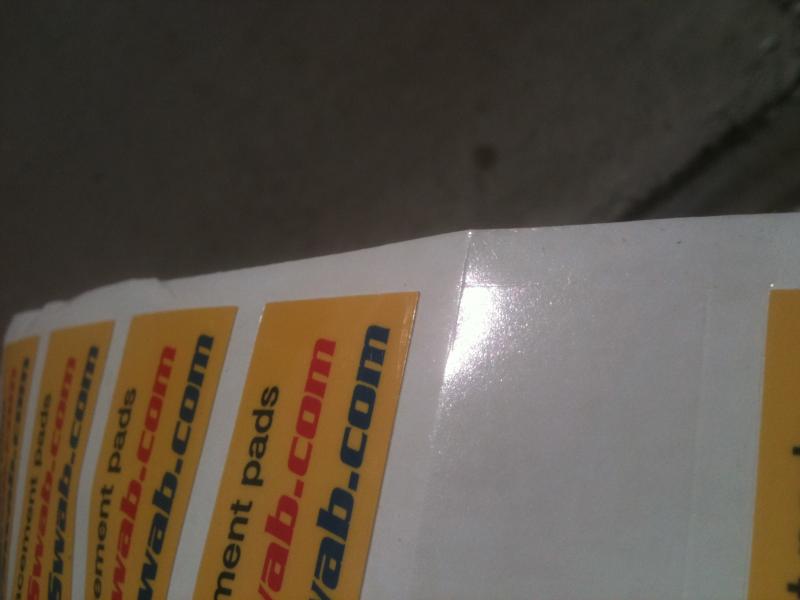

For argument sake I just dug up some 3164G laminated and cut decals.
I tried to get a better pic to show the cut line but it doesn't show well. There was absolutely no shrink to it at all. These were printed then sat for 24 hours and laminated with just a cheap lam.
They have been sitting around on the liner like this for months.
