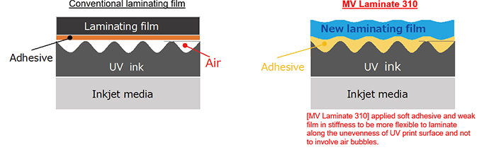

I'm looking into this machine as well and was looking at laminate options since the ink is textured. Mimaki makes a laminate called Mimaki Vision Laminate 310. It's supposed to be more flexible to fill in the gaps between textures surfaces of the UV ink. See attached image. I'm sure there is other options but this is just what I saw while researching the UCJV300
