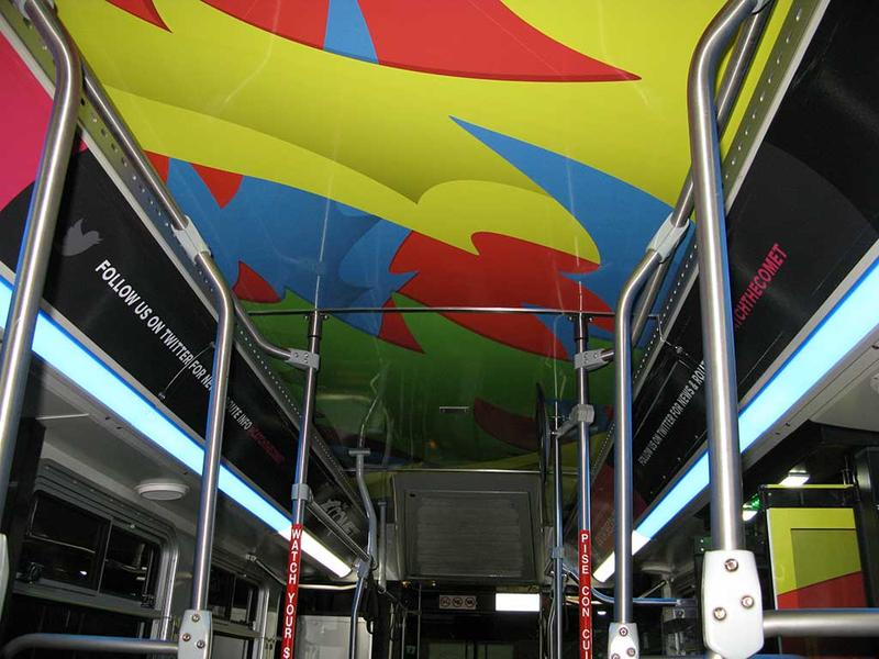

How about wrapping the entire inside ceiling of some buses (we have done a few dozen of these) :smile:
