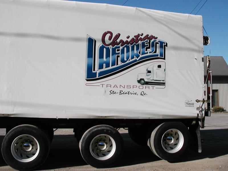

Here's the picture. I've done this job for an owner/operator of my neighborhood wanting the same design I did on the cab but scaled to fit his new tarpaulin. Job done with 3M IJ180C + liquid laminate (graphics were about 4' x 4', everything is printed, even the ½ line). Post-heated carefully. 6 months later, it began to crack & peel.
'Must admit it has been done in October so the first 6 months were the coldest ones the graphics could stand here in Canada (-30°C, sometimes more...)
Same job in Florida, expect better durability...
Other tarpaulins around here for big fleets are usually screenprinted or digital.
