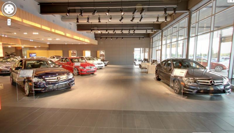

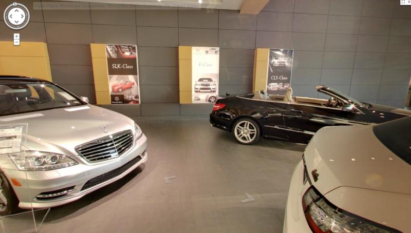

It's indoors at a Mercedes-Benz dealership. I'm going to stick with something a little more subdued. :)
The vinyl is on existing faces that are being reused. So if it doesn't just peel up easily, it's between the heat gun and steamer. I'm hopeful the steamer would be the better choice. I don't really want to run a heat gun in there either.
Moze
Nice...when did Google Mas start doing interior views??
Anyway, these are the panels:
