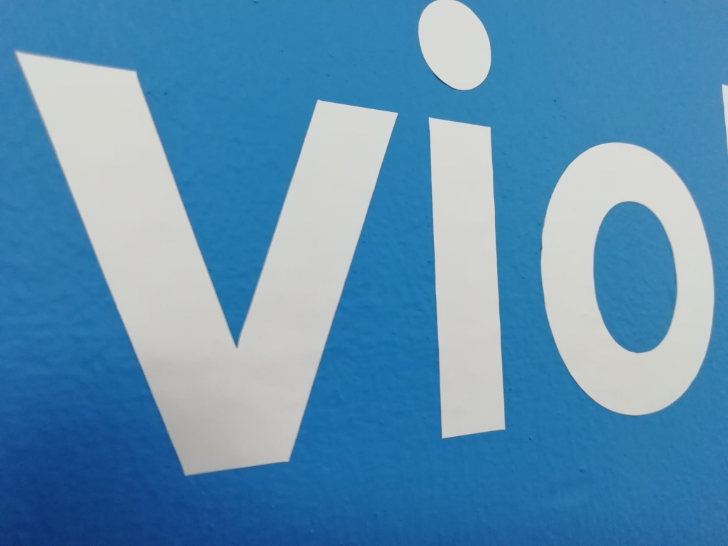

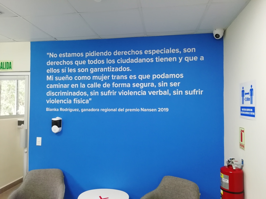

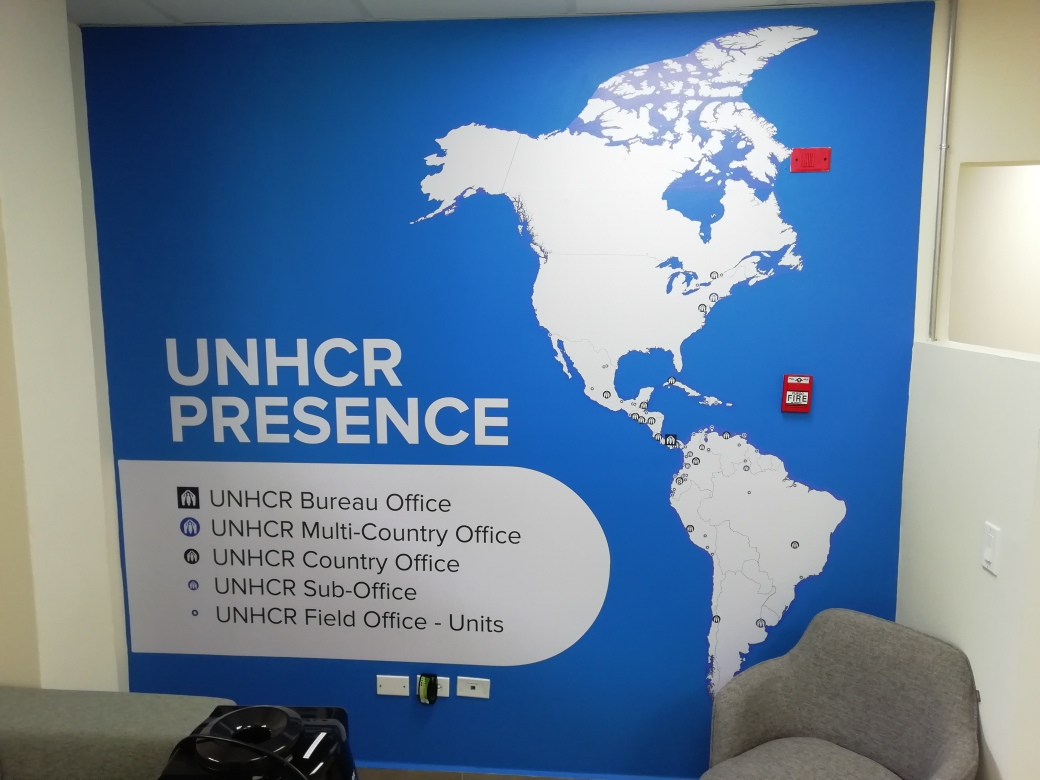

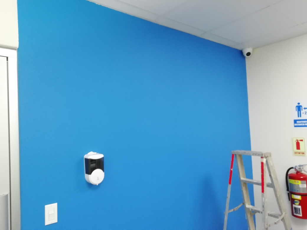

Hello colleagues ! I just finished installing the vinyl I was talking about. I cleaned the wall with alcohol and water solution, 2 times, allowing time for each other to dry. Some paint came off, but nothing major. Then I did some little tests and voila, it worked !! Thanks to colleagues who pointed out the best way to handle this problem. I recommend it !! I attach some photos

These look great! And may I say, smart choice to colour-match the top of Canada instead of weed it - I say this from experience, as we did a world map on a car once o_O
