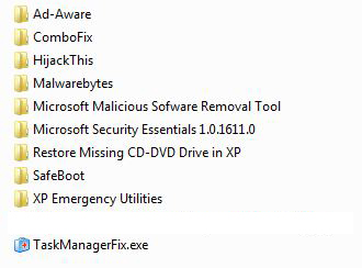

    Here are the tools I use for XP ONLY . . .
