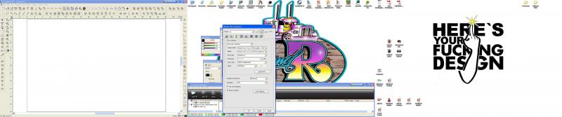

make sure your using the correct profile in the Production Manager for the media you are using ..... to check this open PM and double click your printer to open your printer property's and go to the 3rd tab over(Color management) and choose a profile for the media your using.
