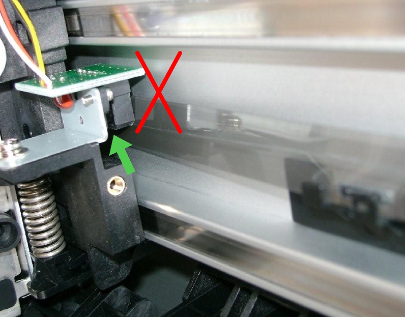

In the original 1204s, E068 can be the rail, the carriage, the CR motor, connectors, CR board or Mainboard.
You should check to see if there is any binding in the carriage by manually moving the carriage back and forth while the Printer is turned OFF. Any binding could be the source.
You can also run endurance cycles of 50 or more from the Life:Cr motor diagnostics menu and see if the error repeats.
Clean and lube the rail, check the carriage bearings if there is some binding.
Make sure the head release is being activated IF the error is occuring while the head is over the capping station.
Compilla
Sign Warehouse will know about the 1204AS.
Randya, after manually moving the carriage and inspecting the T-fence, we notice that T fence came out of the Fence guide on the back of the carriage.
We put it back and worked like a champ...
Thanks!!!
