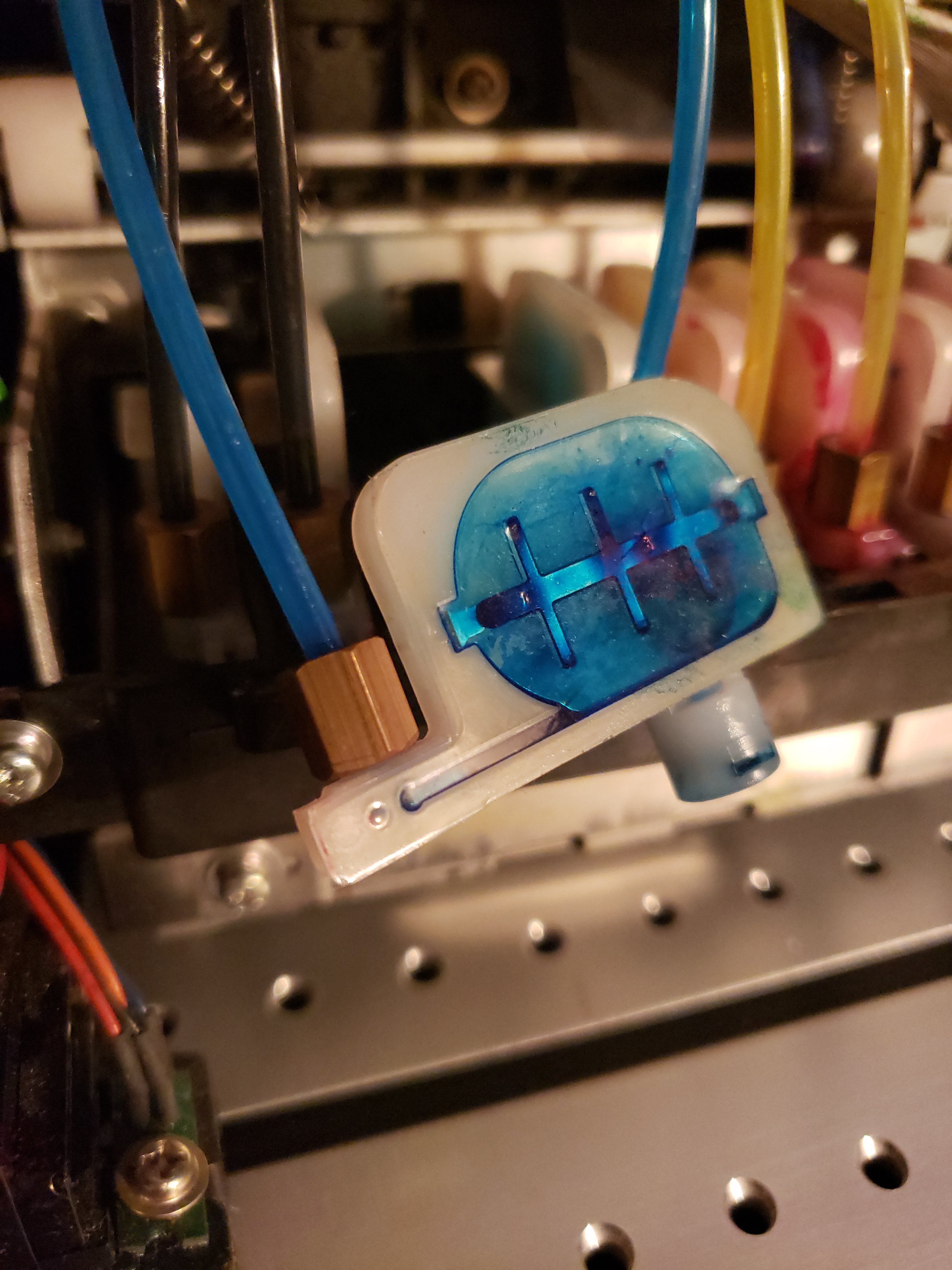

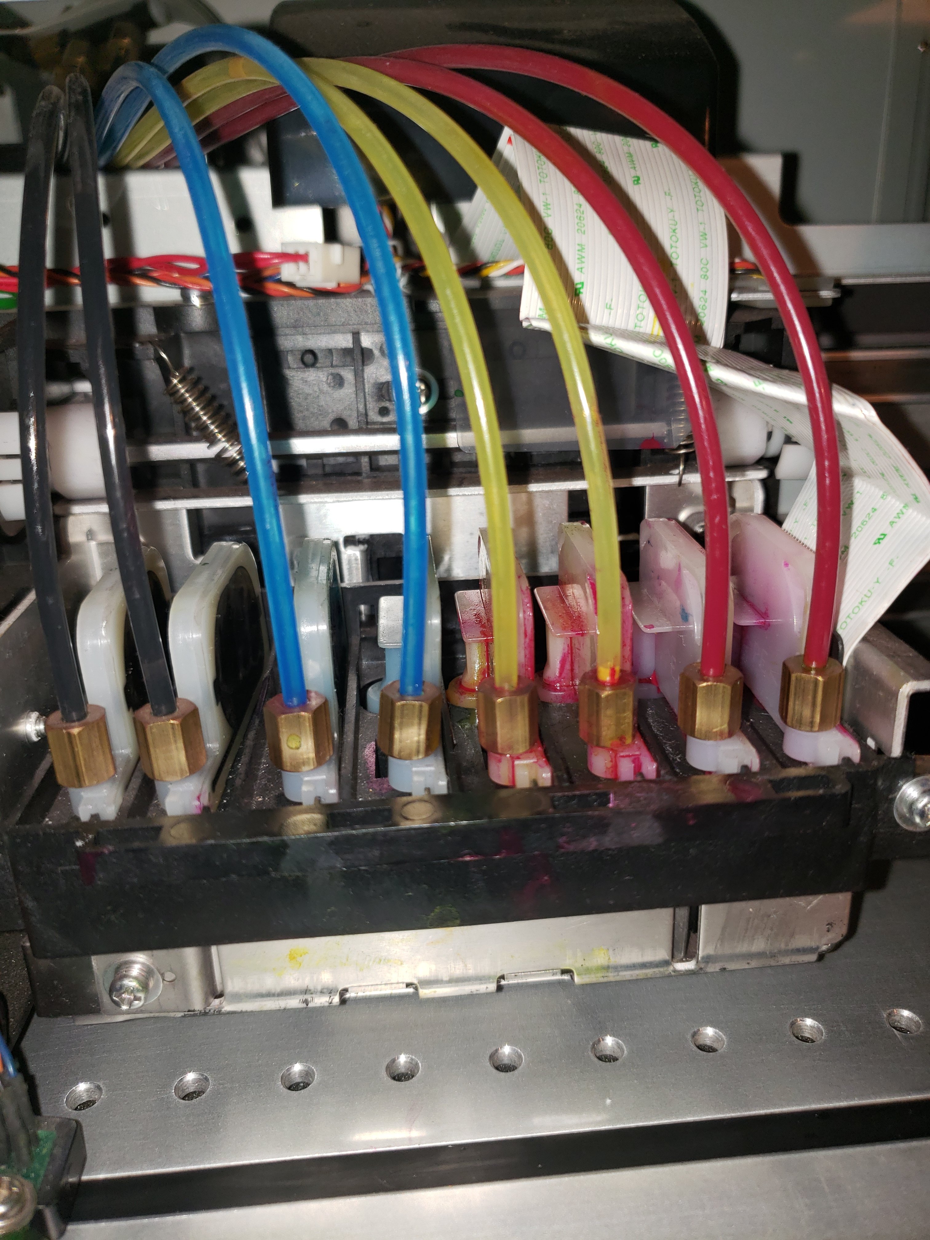

I installed a new ink, Ink was not filling up. I removed the dampers and pulled ink through the lines, the black filled up, the magenta filled up, but I could not get ink through the cyan and yellow. I keep hearing about O-rings I attached a pictures of my dampers am I missing a o-ring or something?

When you pull with the syringe do you get an suction at all or just pull air? A lot of suction but no ink means something is clogged. No suction and a lot of air means there is an air leak which could be a bad o-ring. Keep in mind that each color is connected so pulling from just one side will usually pull air from the other side. I usually just put my finger on the other damper to keep air from making it in or use two syringes. The o-ring you want to look at is underneath the brass nut that connects to the damper.
Also, there is a lot of magenta all over the yellow dampers. Is that just from pulling with the syringe and making a mess or did it come from somewhere else?

When I pull the yellow or cyan I only get air no suction, should the o-ring be visible? i dont see any o-ring on the dampers. See attached photo.
Can someone post a photo of the damper with the o-ring attached?
The magenta ink on the yellow was me making a mess. :)
Usually the o-ring is stuck inside the brass nut. If you push it up the ink line it should pop out of place and be visible on the ink line.
It's pretty hard not to make a mess with these dampers! After years of working in the field I still make a little mess once in a while.
