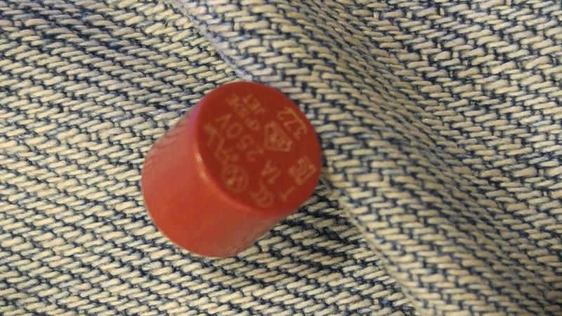

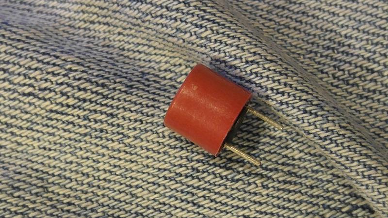

Does the panel still work? Does it do anything? When this happened to me (I unplugged the control panel without unplugging I first) I could turn the printer on, and the power LED would work but it wouldn't turn off and I couldn't do anything else from the control panel. Ended up being a blown fuse
printimage
The lights coming on and it will move the head but no display on the screen. Where is the fuse located and how will you know it is blown?
TDFcustomSL
The fuse is located on the main board, it is a small round redish orange color. I had no way of testing it so I just replaced it and it fixed my problem. I was unable to find the fuse anywhere online so I had to contact mutoh directly. I might actually have a spare I could send you since I am getting ready to sell my 1204. I will dig through my cabinets and see if I can find one
printimage
Thanks i will take a look and see if i can locate it on the board. I would like that only thing is i am in Barbados so it would have to ship to me.
TDFcustomSL
this is the fuse

printimage
Thanks for showing me, I found it and i tap the top of it and turn on the machine and the display is showing
So it seem the fuse mite be going bad. When i get the fuse how can i get it replace? Would i have to send the board to mutoh?
