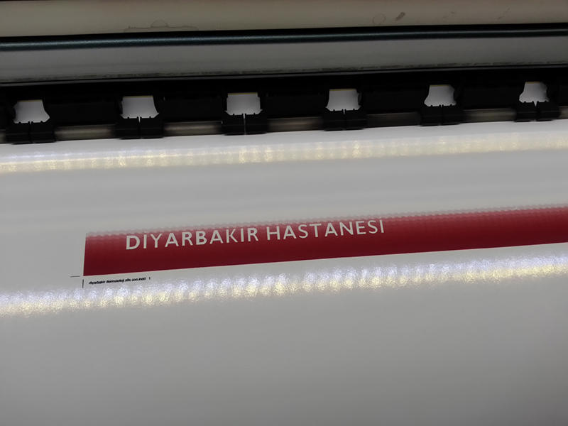

Hello
Mutoh ValueJet-1604 machine into the problem that most of the pressure.
Tively the same color that does not exit.
You need Oracal 3640G 3640 3641 Ultra-paper profiles.
Can you help me?
uzmanlar
Trying to explain to you the pictures. my english is not so good.
Color of the underlying image file
I print the color of this.
heyskull
What type is the original file you are printing from?
What material are you printing onto? As the material looks very rough/textured.
Are you using the correct profile for the material?
SC
uzmanlar
Tif file.
3640 3640 G 3641G ORAJET type foil glossy paper.
Profiles of paper profiles. I am using Mutoh dye, where profiles can be obtained?One did not match any profiles. Can you help me on the profiles?
heyskull
Is your test print good?
If you have a lot of nozzles out you will never be able to come anywhere near proper matches.
I have had a new print head installed in my 1604 recentley and even though the previous head had only a few nozzles out the colour matching has improved loads.
What RIP are you using to print from?
I would possibly find out what the colour is meant to be (either CMYK or RGB).
TIF files are not the greatest files to be using and are mainly used for web pages as they can be compressed a lot.
Get your client to give you the file in a different format preferably a Vector file (EPS, AI, PDF)
SC
uzmanlar
There are lines on the print lighter.
I want to get rid of these lines.
What is the solution?
I have a program and a key driver Photoprint 6.
I would like to use this lock-PhotoPrint 10.
Please help me, its pressure head is very poor and my machine has changed 2 times.
