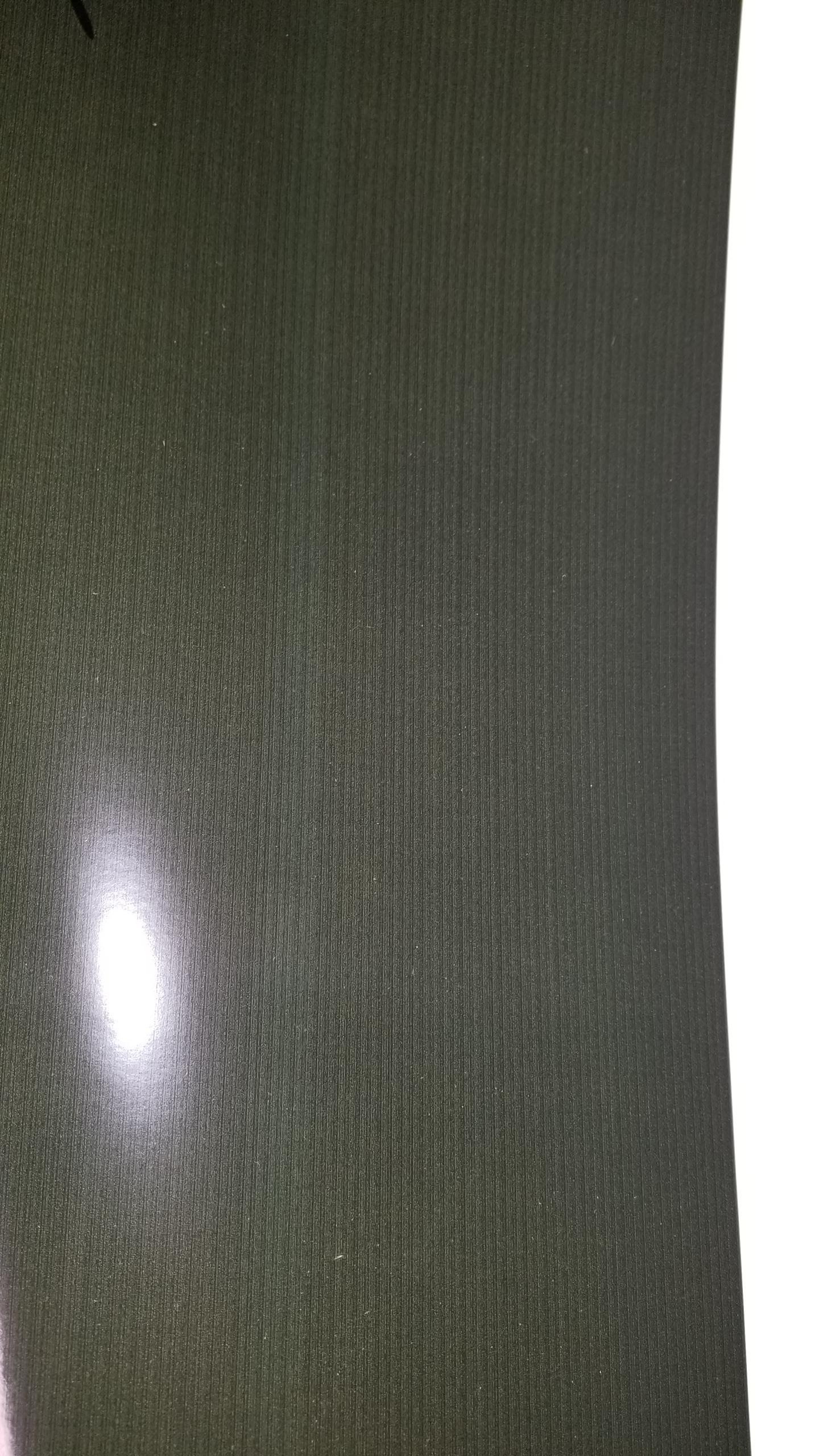

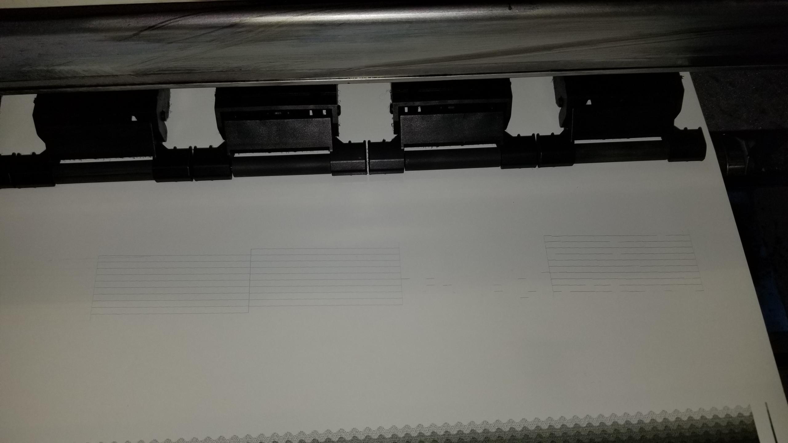

Thank you VanderJ for the suggestion. I did find that the left side line at the damper had a small leak in the white nut so I repaired that and performed a little clean on it and the damper filled up about half full as well as both lines....when I did the test print, this is what it is doing now. I have provided pictures for you to look at, if you wouldn't mind. The black is printing a dark green color and one block is not printing one side when I do the print check.. I have not checked the fuse because it is printing all colors, just not black as the black color......
