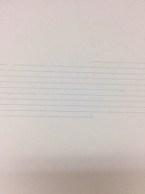

Hopefully someone can help with a problem I have.
We printed an image yesterday to find an extreme overspray on the cyan, it almost looks like it's dragging a hair and any colour that's heavy with cyan is banding. I've tried cleaning everything and although I can get all the jets firing, all be it after a small test print, I'm not getting the vertical line that is normally seen in the nozzle check. I'm also getting a cyan line down the edge of the media guard, as if the head is constantly overspraying, when printing a cyan block.

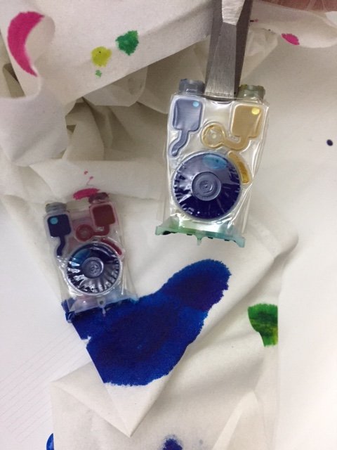

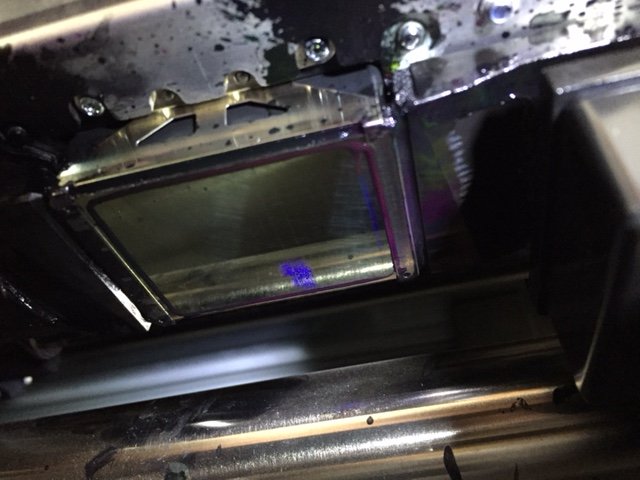

I've taken the dampers out and, although I'm not sure what I'm looking for, they seemed ok. The head looks to be ok except one time I did notice a pool of cyan as shown in one of the attached images.
Has anyone ever experienced this? Could it be the print head that's gone?
Thanks for any help!
(For some reason the images attached are rotating. There should be, when coming off the printer, a vertical line between the 2 banks of nozzle checks and the print-head image is upside down.)

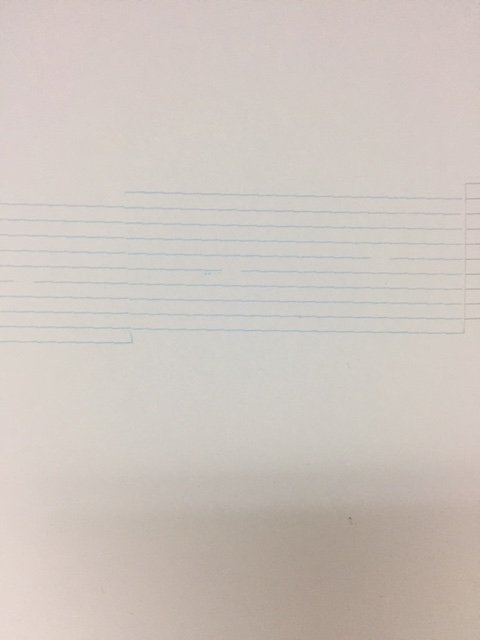

A bit of an update on this in that I've noticed that the cyan jets are all printing a bit late. The image attached shows they aren't quite hitting the black.
As all the nozzles seem to be physically printing and that it's only the cyan that's printing late I'm beginning to think it may be a board issue. Has anyone got any ideas?

The encoder strip seems to be in good condition and I've given it a good clean to be sure.
Printing images tend to be ok however colours that require a lot of cyan have the horizontal overspray.
Here is an image showing the maintenance head adjustment pattern.
