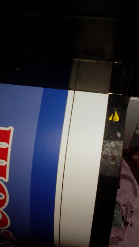

when i send a job it is printing a black line at the beginning and the end of the image. Also the print head is moving the full width of the media, how can i get it to just print where the image is?

i believe that is part of the splitting settings. its in the menu on the mutoh, i can not remember exactly where. but yours sounds like its set to on media. it should be set to one of the other settings.
Its been a while since i have played with my mutoh, but this is what your looking for, just can not be more specific

To get the black line to stop printing:
Menu>Setup>Flushing> Change the setting to Origin instead of media
To get the printer to only print over the image:
Menu>Setup>CR Movement> Change this setting to Data instead of media

HI i am not seeing flushing in the setup. also the CR Movement

Most likely, the person who setup your printer turned those menu options off. You should be able to go into Menu>Setup>Temporary. In this menu it will list all of the menu options available and the ones with the * next to them are the ones that will show up. Scroll through and find flushing and Cr movement and make sure they have * next to them. Then they should show up in the setup menu as they should temporarily. Unfortunately I cannot remember how to make them show up permanently. It's in the service menu somewhere.
Edit: Forget about the *. It looks like you should be able to just get into the menus you need under the temporary menu. Just tried it out on a 1604.
