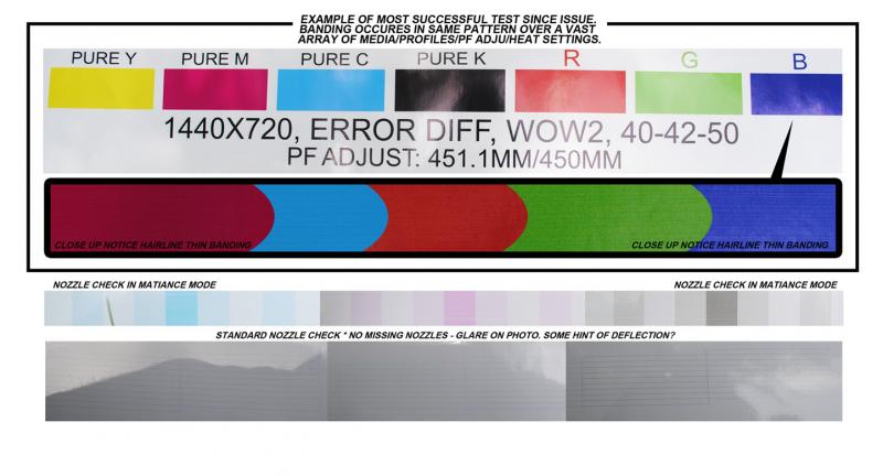

I am having a strange horizontal banding issue with my 7 month old VJ1204. This issue popped up out of no where after running without a hitch the whole time I have owned the machine. The banding exists in the same pattern no mater what media, profile, resolution, heat setting, print direction, wave form ect that I have tested. The banding is extremely light, hair line thin with a "scratchy" physical texture in every color. Nozzle check shows no missing nozzles but some minor skewed lines. I have never quite seen a issue like this, I have been down for 4 days testing every tip and trick I know and at this point I am out of ideas. I use to be a maint tech for Brother and Kornit direct to garment printers, I am very picky about maintenance & environment and keep all of my equipment very clean and maintained.

I am sure I am forgetting a few things. My first initial thought was profile-nozzle-PF but all have checked out. Though I am not a expert at reading the nozzle test, there are no missing nozzles however some of the lines are slightly skewed. The maintenance mode nozzle test showed some heavy lines. I do not know the proper way to read this test though.
No change in environment, room ranges from 68-72 degrees, 55-65% humidity
Please see attached photo, I tired my best to show the issue so it makes sense. Any help or ideas would be greatly appreciated. The machine is still under warranty I am in the process of sending all this to the techs, just thought id throw it out here to, thanks!

Stealth- Thanks, I keep going back to PF adjustments, In most of my tests it just seems/looks like the only logical answer. Henry- You are correct, I wrote "skewed nozzles" on the image, misdirected is what I should have said. This has cleared up, I should have taken a photo of a more recent nozzle check. The thing is that only a couple of nozzles in M and C were slightly misdirected, the banding or streaks runs uniform across all colors. This test shows 100% CMYK swatches, and the streaks are seen in every swatch in the exact same spots. That is why I keep going back to PF.

I have a lot of experience with feed issues for various reasons and I can tell you with confidence that isn't a feed issue. Feed issues would leave more consistent banding or at least more distinct banding if not consistent. These lines he is getting you can see while it prints the pass before the feed has even kicked in. On my end it almost looks as if the nozzles aren't firing, but I don't think that's the case.
