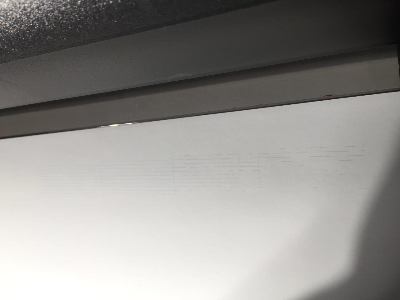

Again, many thanks for your info. I have included a picture of the current nozzlecheck status (CYM= perfect, K channels: one has maybe 20%, the other more like 70% of it's nozzles; previous owner claims he did a nozzlecheck every week from end of production (october) till beginning of januari (from when i've picked this -seamingly- marvell up). Capping and pump seem to work fine as i see 'lots' of ink going to the waste container.

i guess? That is the case but i clearly feel more resistance in the black channels (which are clearly clogged (see pic)). So i guess i must keep 'pushing' cleaningsolvent with a syringe on those channels in an effort to unclogg her.

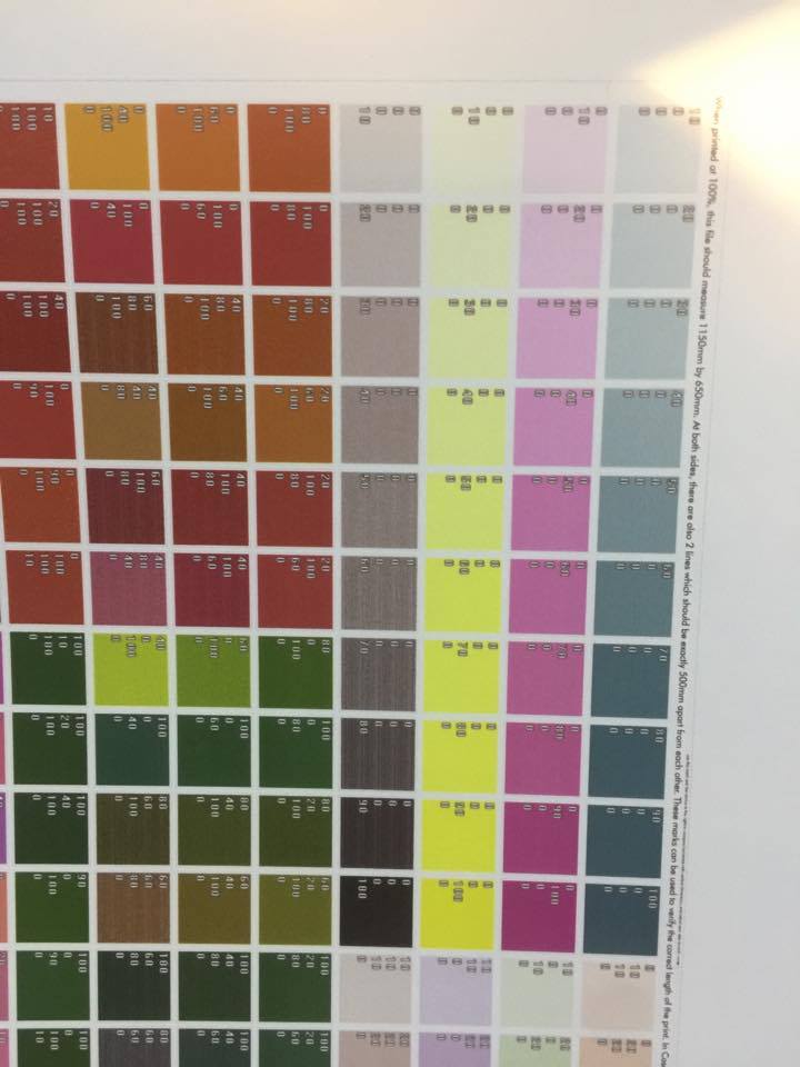

- risk: yes i understand the risk, but i cannot print anything right now so i feel the risk is bigger in leaving the printhead clogged like she is right now as that renders the printer useless (see color patch print test: black and darker colorpatches suffer a lot) :-S
