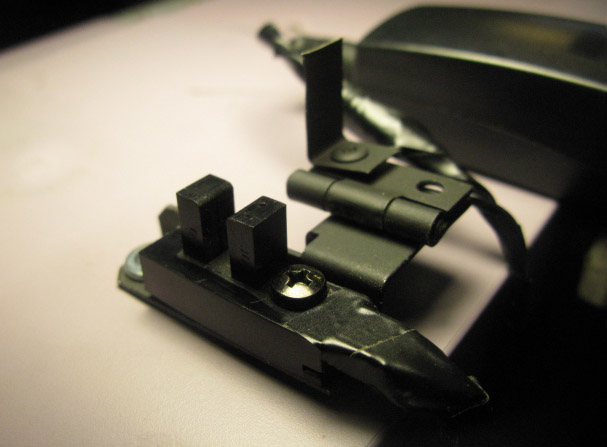

this may be kind of up my ally in that my jv3 is converted to a flatbed. if you are talking about the black rubber thing that the media sensor "sees". i've put a strip of white tape inside of mine so that i get a maximum read on width. no matter if i'm printing 10" or 64" the printer always reads 63.9". and i can place the sheet wherever i want or up against the guides. on boot the printer just measures the tape, no media loading required.
also i've rerouted the pinch rollers "lever up" sensor to the outside of the machine (it's a simple IR switch). loading sheets on a jv3...everytime you lift the lever, it wants to remeasure. not anymore. not sure if your 1608 does this.
