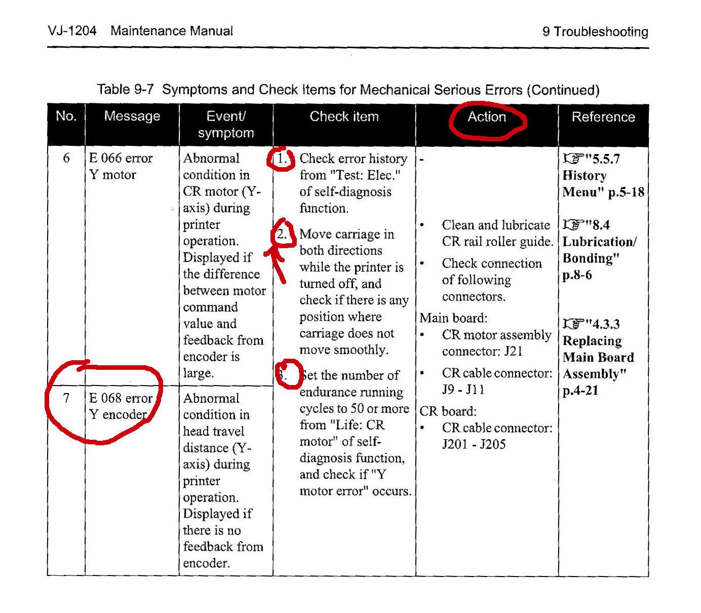

This was on here a little ways back.
E068 on the 1204 is the carriage / head travel that doesn't match the encoder feed back to controller.

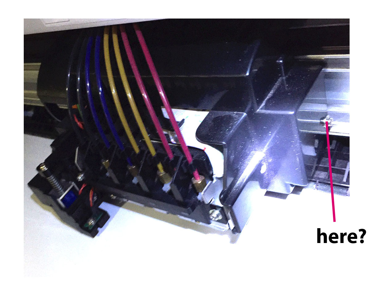

GAC05
Quit buggin' me
Did you clean the sensors that read the encoder strips? The one on the carriage head can pick up as much ink mist as the strip.
If you haven't done it before:
It is on the right side of the carriage under a plastic cover held down with a single screw. I've taken mine off - wrapped a lint free cleaning cloth with a little alcohol around the edge of a credit card. Pass it between the gap in the sensor until it comes out clean. When you put it back make sure it is centered on encoder fence and not rubbing. This worked for me more than once - even after a new fence install failed.

GAC05
Quit buggin' me
Yes, that black plastic cover needs to come off. That screw plus the 2 on top behind the ink tubes. I think you can wiggle the other end out from under the left hand cover. If it won't just take off that cover two (it's been a while).
Once you have that off you will see the sensor sitting over the plastic encoder strip. Note the position so you can put it back in the same spot (centered over the fence). Usually there is a shadow of ink mist to use as a guide.
