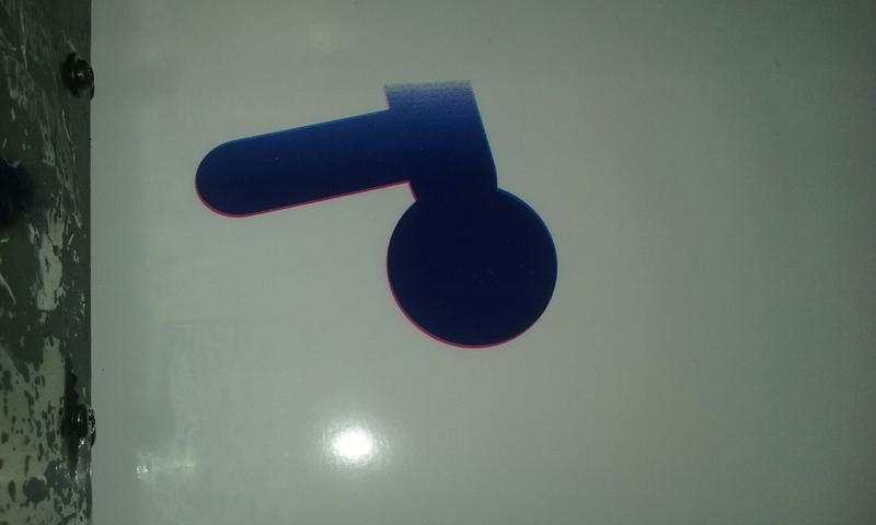

So I've installed print heads before but now for some reason the Magenta / Yellow print head is offset in the printing. I checked the carriage to make sure they were in place and even ran a measuring tape. They seem ot be in place is there a way to calibrate the printheads up and down. I already calibrated them left to right atleast for the most part.
Any suggestions??

You need to run the alignments in order and do all of them. The order the alignments are in the service menu is the correct order. Once you have done the service menu alignments, run the user menu ones. If you do that, your issue will go away.
Physical Alignments - Require Tools
Bias - aligns the heads individually to be perpendicular to the head movement
Vertical - Aligns the heads to each other up and down
Electronic Alignments - No Tools just enter numbers
Horizontal - Adjusts the timing of the head firing so that each head fires the same distance away from each other
Bi-Di Default - Sets a base point for the user menu bi-directional alignment
User Menu
Bi-Di - Adjusts the head fire timing to keep visual integrity while printing in both directions.
Calibration - Adjusts the print feed rate to fix banding issues.
