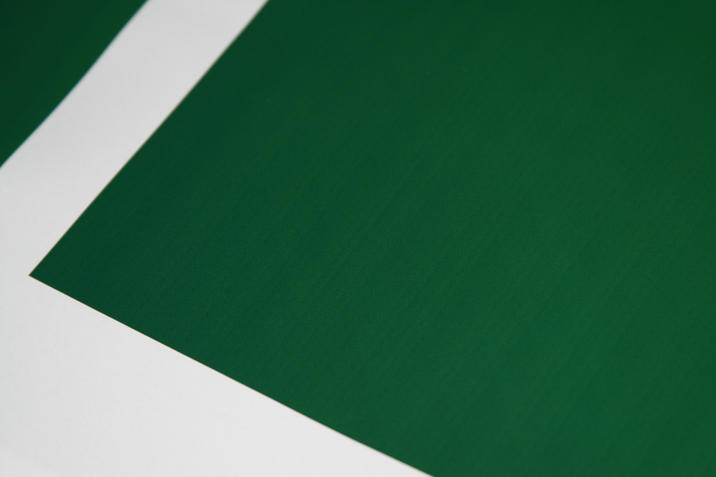

i´m uploading a photo to illustrate better the problem.

it´s not very clear in the photo as it seems a "normal" banding. but it´s not. It makes a cycle. And this file has a gradient. I printed another file with no gradient but a darker green and it came out perfect :S

here are the photos
i exagerated the constrast in photoshop so the problem is more visible. The diagonal lines are a file problem, thatsa not what i´m talking about. can you see the vertical lines? it makes a cycle. Darker/lighter/darker/lighter...banding usually is consistant, lines all over the print. i never got something like this. Standard quality uni dirrecional printing
