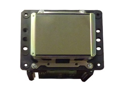

Roland VS 640 use a professional Roland head, in China, we call it DX6 head. Absolutely not DX5 head.
Please check the picture in attachment.
You have to buy original Roland VS 640 head, of course, you can try find a better offer.
