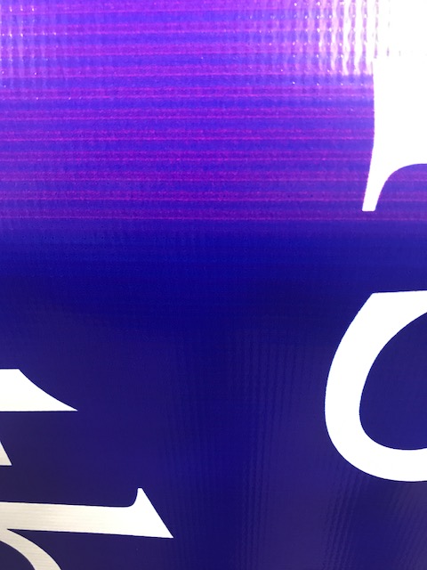

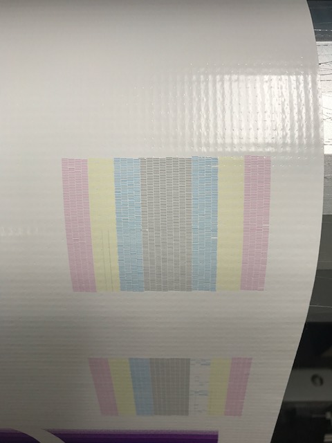

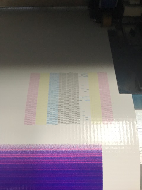

Hi all. I have a VS540 that is dropping out the Cyan during printing. It will stop printing at the exact same point on this particular print. Others it may stop at a different point or not at all depending on how much Cyan is used. When I do a test print the right Cyan stripe is almost completely gone. I can then do a powerful cleaning and another test print and the Cyan comes back. Also, one of the times I tested it the Cyan and Black channel next to it were gone. After the powerful clean they both came back. Any help will be greatly appreciated!

When a certain color drops out during printing it's almost always a failing damper or bad connection between the ink line and damper. Dampers are maintenance items and should be changed at least once every 2 years but I would change them once a year if I ran a machine. Most people just ignore them until they fail. I would start by changing them if they are older.
Other than that, anything that restricts ink flow or allows air into the system will cause this issue.

We replaced the cap top and dampers yesterday. Unfortunately we had the same problem. It's very strange that it runs out and the exact same spot.
Solventinkjet
DIY Printer Fixing Guide
When this problem persists even after changing cap tops and dampers, either there is an air leak somewhere in the ink system (especially if you use a bulk system, or there could also be damage inside the print head. I always check the ink cartridge to make sure it's not empty and not flagging the machine which would cause similar issues.
