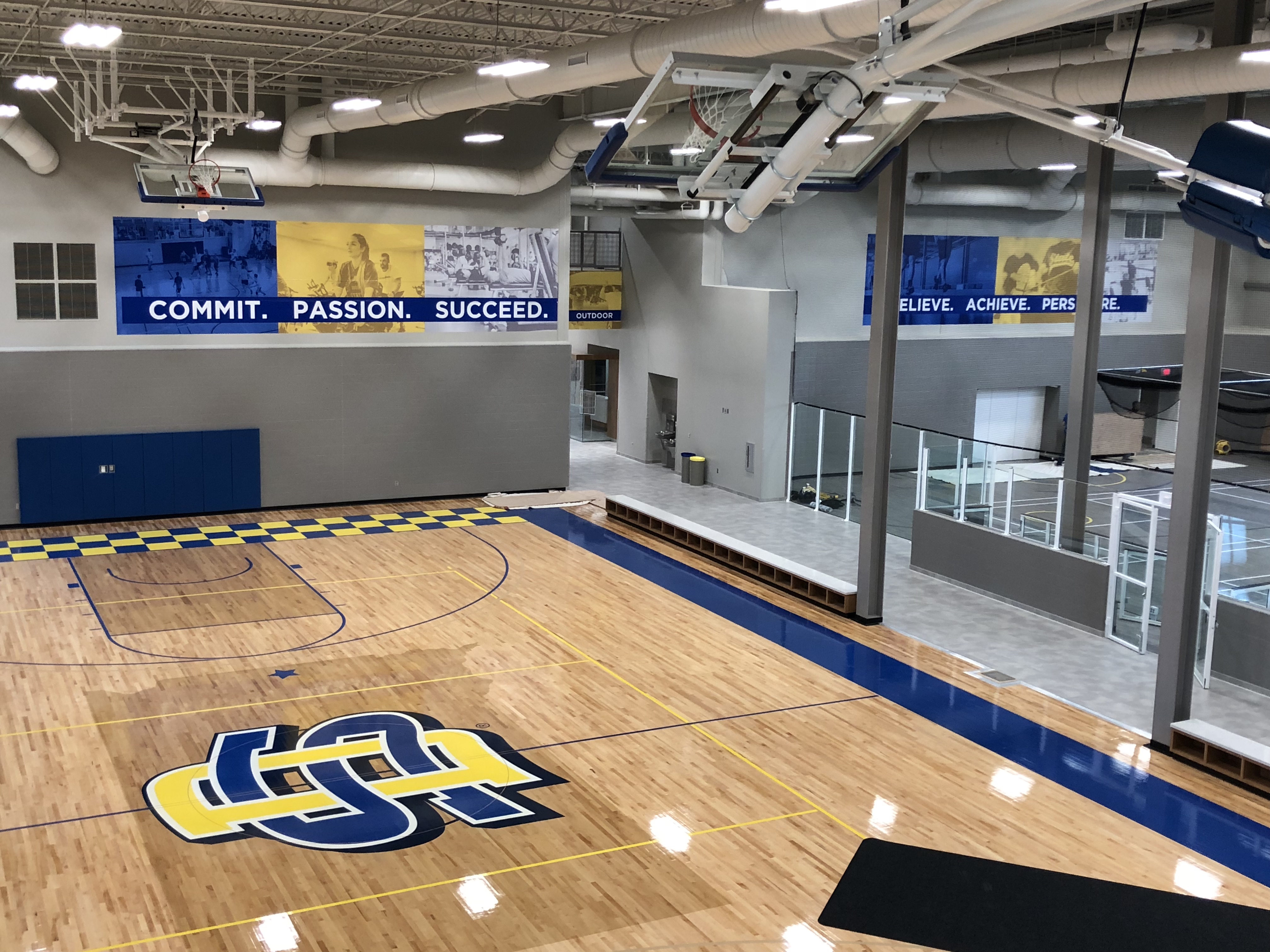

We have seen an increase in the number of customers wanting large wall murals. One of our latest clients is the athletic dept of the local university. They just built a new wellness facility and have asked for multiple wall murals throughout the building.
Here's my concern. We have a Roland printer and have used 3M IJ40c, 3M IJ35c and PhotoTex in the past. I like the install of the PhotoTex, but not a fan of the color vibrancy. IJ35 seems to really stick, but won't stay stuck over time. So, we've researched online and started using IJ40 with component 3M Luster laminate per numerous online articles.
Put up a couple 8'x40' pieces last week on a smooth, interior sheetrocked wall painted with zero VOC Sherwin Williams semi gloss paint the week prior to install. Applied the vertical pieces, went over the ENTIRE thing with heat gun and rollers to ensure adhesion. Looked GREAT. 4 days later get a call that some of the panels were starting to let loose and curl away from the wall at the top. UGH.
We have another wall to do for them next week that is pre-cast concrete with smooth paint. I'm hesitant to use proceed until I can get some advice. TIA
