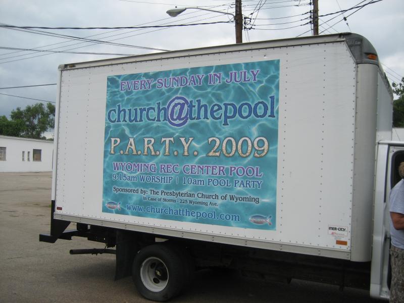

We use our sp540v for everything, we do the small white border on them, never even tried cutting on edge of print, but I can't fathom a problem with it? Indoor applications with GMI, outdoor would require a permanent adhesive... although phototex works fine outdoors in our experience.
