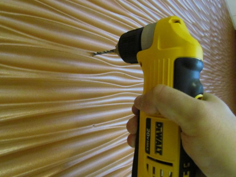

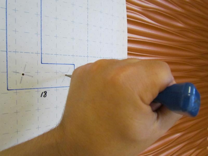

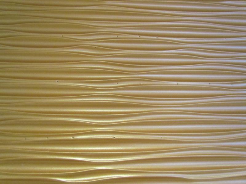

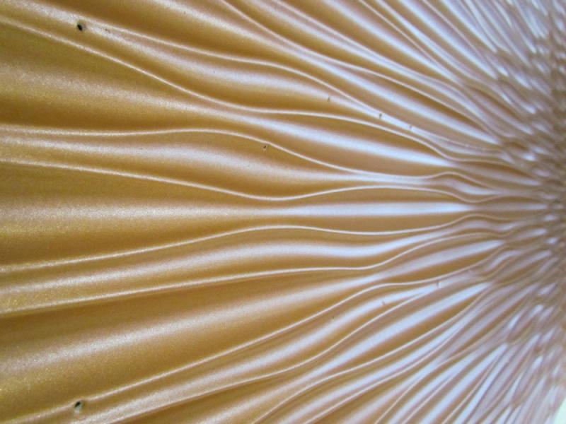

...meant every hole had to first be punched with an awl so the drill bit wouldn't wander on all of the ridges. It wasn't that difficult, but more time consuming than normal. Anyway, nothing big...just bored, figured I'd post.
(some of the pictures are possibly going onto my website...I don't usually take pictures of my hands and tools):rolleyes:

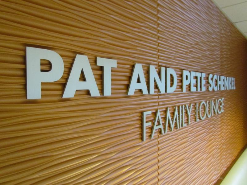

Frankly I would only put finished picture on website.
It is a superb picture of a impossible looking install. great for sales

ah looks like the work of some architect jacked up on starbucks. I do like the wall though it is different

Thanks Craig.
The goofy pics with the hand & tools were more for the little sliders on the website (click).
Yeah, the wall was pretty different. Initially I was told it was wood, which would have been pretty cool. I was kind of disappointed it was plastic panels.
Nice job Moze.
I like the wall panels until I saw the last picture showing the seam.
Agreed...they seemed kind of out of place for the complexity of the texture of the wall.
Great work! Must've been a challenge getting all the studs in perfectly.
Same here.....I thought those were supposed to be seamless panels?
http://www.modulararts.com/panels/designs.html
Guess they just didn't install them properly.

The placement of the holes wasn't bad since I had the scratch awl - I was able to puncture the plastic and I just used a brad point drill bit so everything stayed aligned pretty well. Would have been a huge pain otherwise.
That looks great Moze. Nice pic for the portfolio
Thanks! If I can ever get my web guy to get it on there. :rolleyes:
(....any prizes for multi-quoting?)
SD&F
Moze, I personally like the wall. It is very unusual and many compnaies that claim to be artisits would have charged a great deal for that.
