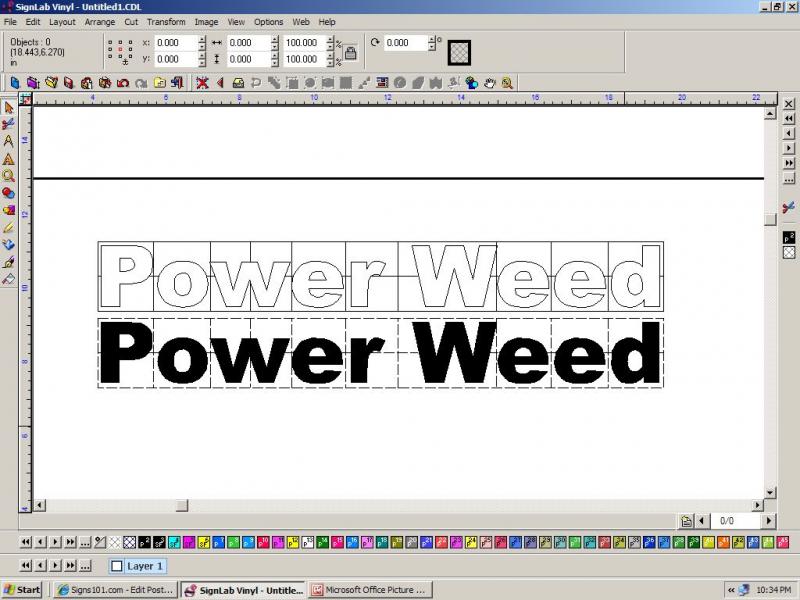

James Burke
Never even heard of power weeding. How does it work? :thankyou:
Power weed isn't something from the 60's...It's a feature that allows you to put in extra cut lines between elements so you don't have to weed such large pieces of vinyl...which usually flip upsidedown onto the lettering...and really makes a mess.
In SignLab, all you have to do is click on the power weed button and then drag as many weed lines onto the image as you feel is necessary. It does not cut into the lettering.
JB
Custom_Grafx
Wow that's some neat trick - nice one.
I have always just manually used my pen tool in illy to draw around large elements.
The example you have up is a bit of overkill though? Unless it was really big I guess. I usually end up just putting the line in between lines of text and the such.

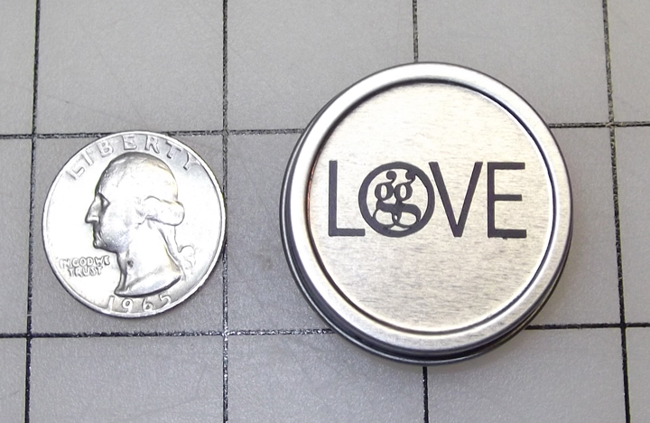

GypsyGraphics
my fingers may be smaller, but i don't weed with my fingers... i use the same big boy tools as you sign guys.
probably has more to do with patients and having worked with micro electronics for many years.
