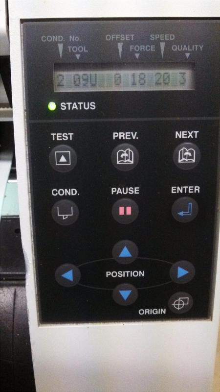

    Settings
    Here ya go. Works fine for me. Same cutter.

    I'm using the same settings as sign man signs has pictured right now but the force is usually a bit lower when I put a new blade in or higher if I'm cutting reflective or other thicker vinyls and of course the quality of the vinyl will make a difference.
