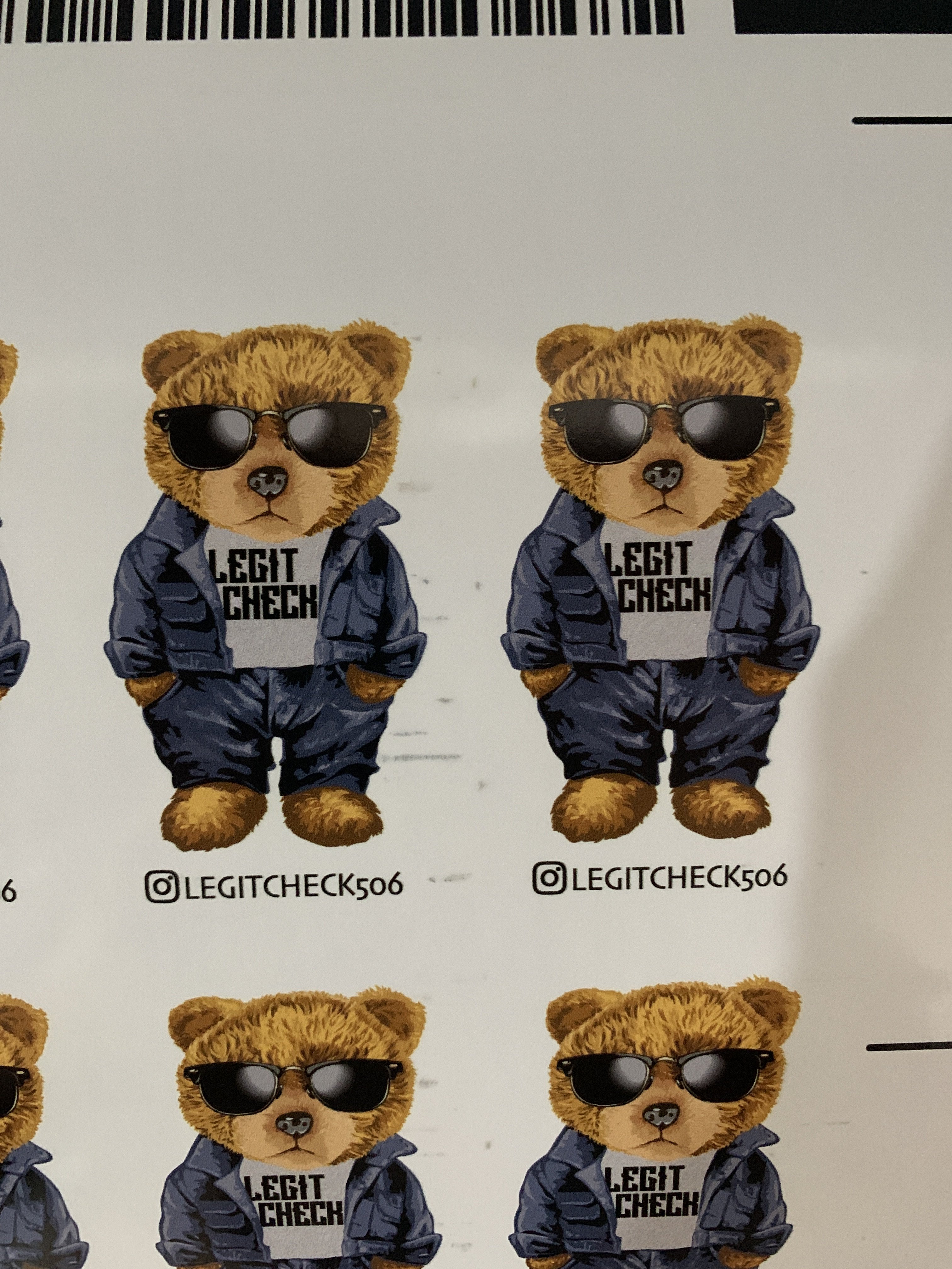

Weird ink stains on unprinted parts
Costaricanprinter
Excel
Had a similar issue years ago, something to do with static discharge when the heads weren't firing to burn off the ink particles in the air (from memory). Solution was to print white areas with 0.7% yellow (the eye can't see it) to keep a head firing at all times.
Not sure if it's the same or if it will work.
