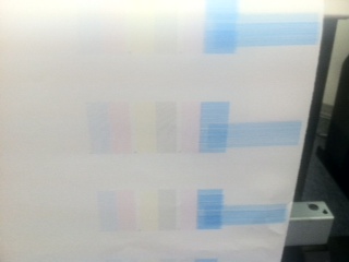

Can anyone please help me here??? Don't know what it is? Roland xc-540

power-down your machine and check your cable connections. printhead ribbons, specifically.
guido
still doing it,
but the pattern changed. i took the cables out and put them back in and the pattern changed... weird.
Robert M
Cables
Take a close look at the contacts on the cables. They are only rated to be removed a few times before they fail. Get new cables before you fry your main board
