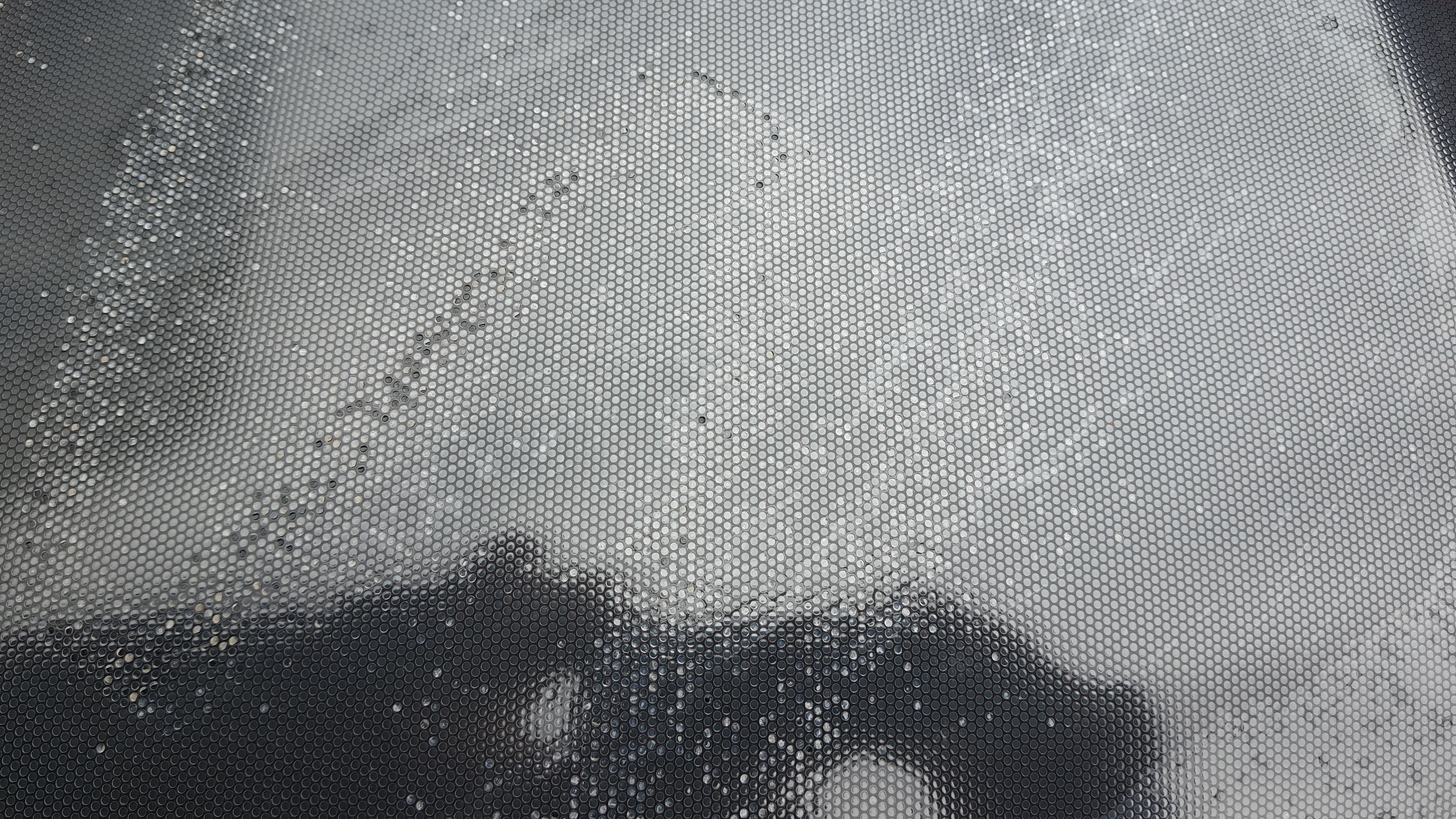

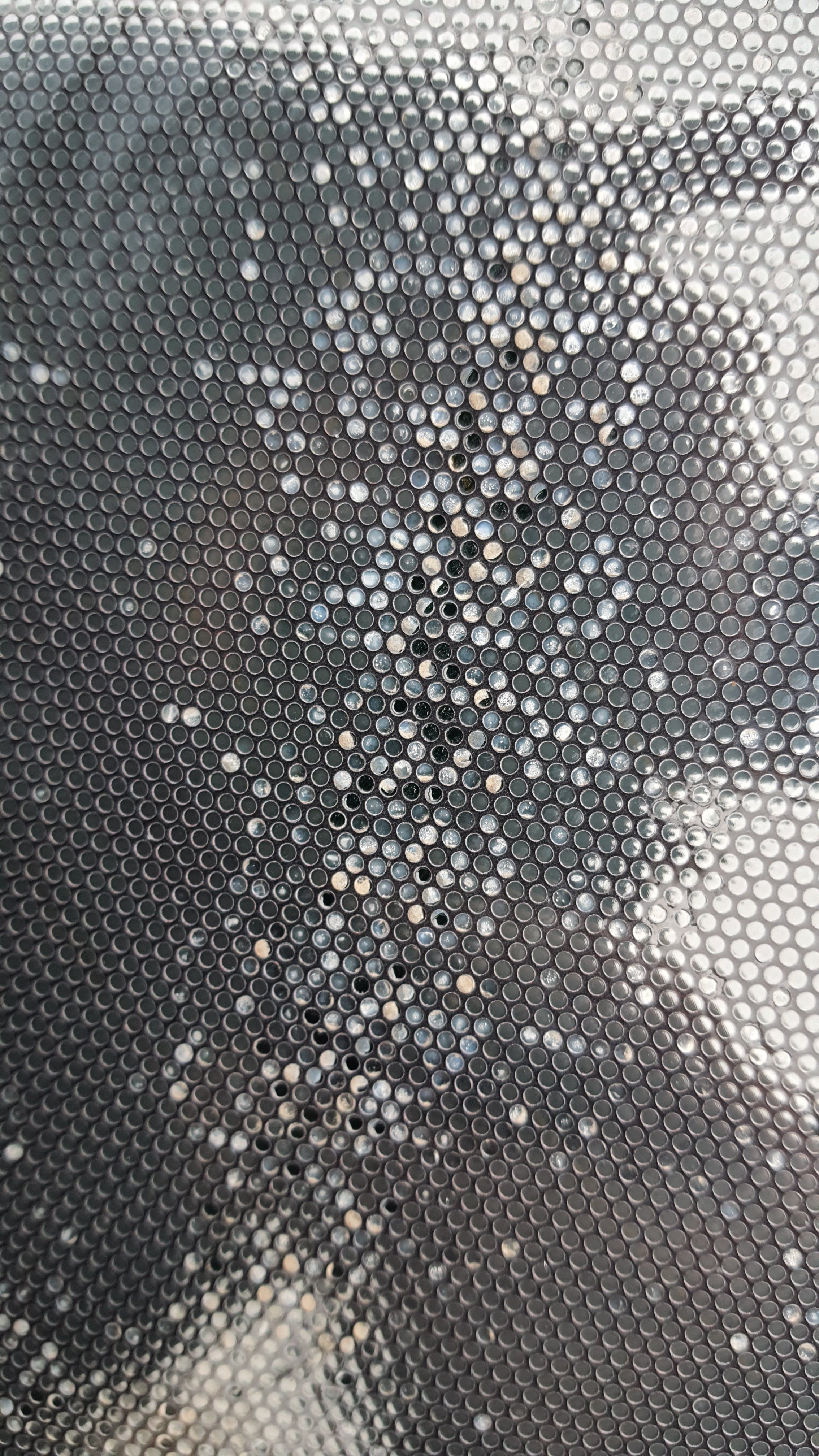

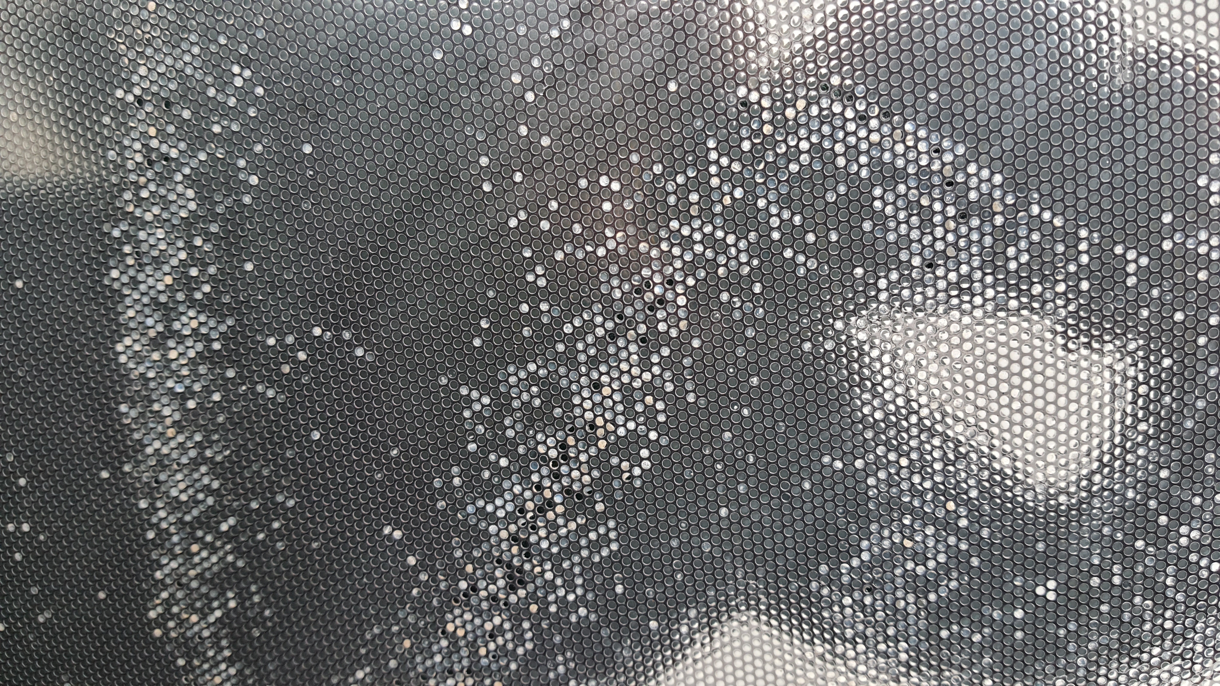

    Hello!
    i have been looking around some car that i have done 1 year ago, and i noticed so problems on lamination on perforated vinyl. I use oracal perforated vinyl and lamination.
    So, as you can see on pictures, laminaton cracs over holes in vinyl... or in some holes there is some mouisture in it...
    so, what is this? material failure on my installation failure?

    Did you use 290GF??

    i think it was 297, which is intented for perforated?

    We usually see similar when clients don't listen to us and use high pressure water to wash the vehicle, blowing the laminate through the perforated holes.

    I agree with SignMeUp..... Tell the customer to stop powerwashing it.

    I agree, its pressure washer damage.

    Or they are using the rear windshield wiper? The laminate gets really brittle when it gets below freezing and anything like an ice scraper, car wash, or wipers will damage those holes.
    Manufactures will give a 2-year max warranty on top of the line perf, but a typical warranty is a year. Clients need to hear the limitations of the perf upfront or you will get bombarded with complaints. They also need to know that how they care for the wrap will have the biggest impact on longevity.
