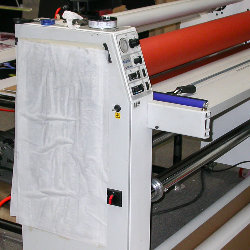

Decades ago these tools for professionals used to be supplied with the purchase of a good lamination machine. There were not “pads” to purchase at the time. The “pad” was simply a swatch of adhesive taped to a flat surface. This blue roller is about 15 years old now.
