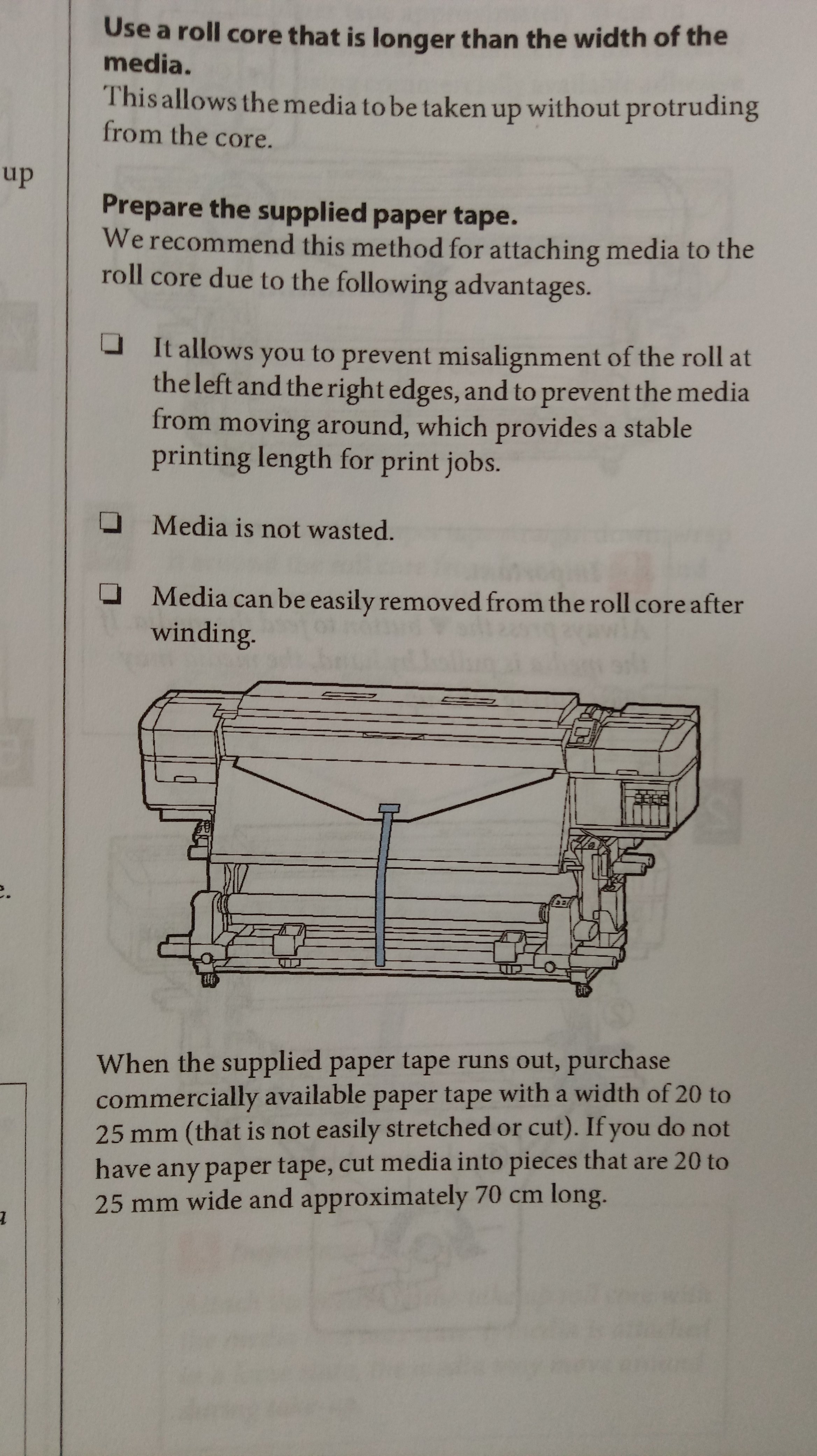

When we got our new Epson last year, it came with a roll of non-adhesive "paper tape" that's meant to be used to attach the leading edge of material to the take-up roll (see .jpg). Problem is, I'm running out of it and can't figure out where to buy more. Alternatively, is there a simple way to make my own, or is there something else I can use?
Thanks for ideas!

First thing that comes to mind is drywall paper tape...
I have never tried this method, but it sounds like a great idea.

Drywall tape! Good idea! Thanks, Andy D!
I really like using the paper tape because it saves you from having to waste a good bit of the vinyl or banner by pulling it out far enough to reach the take-up. I still cut the V and use masking tape. The paper tape is like an extension. I thought it was a weird idea when I first saw it in the manual, but now I love it.

As I stated earlier, my Roland is a huge pain to tape a vinyl lead to a core, so I wanted to try this...
I cut left over 52" vinyl into 1" strips and peeled back the paper backing on both ends of one, stuck one side to the "V" cut vinyl and the other to the core and it worked like
a charm! Thanks again for this info JulieS, it has solved a daily issue for me.
