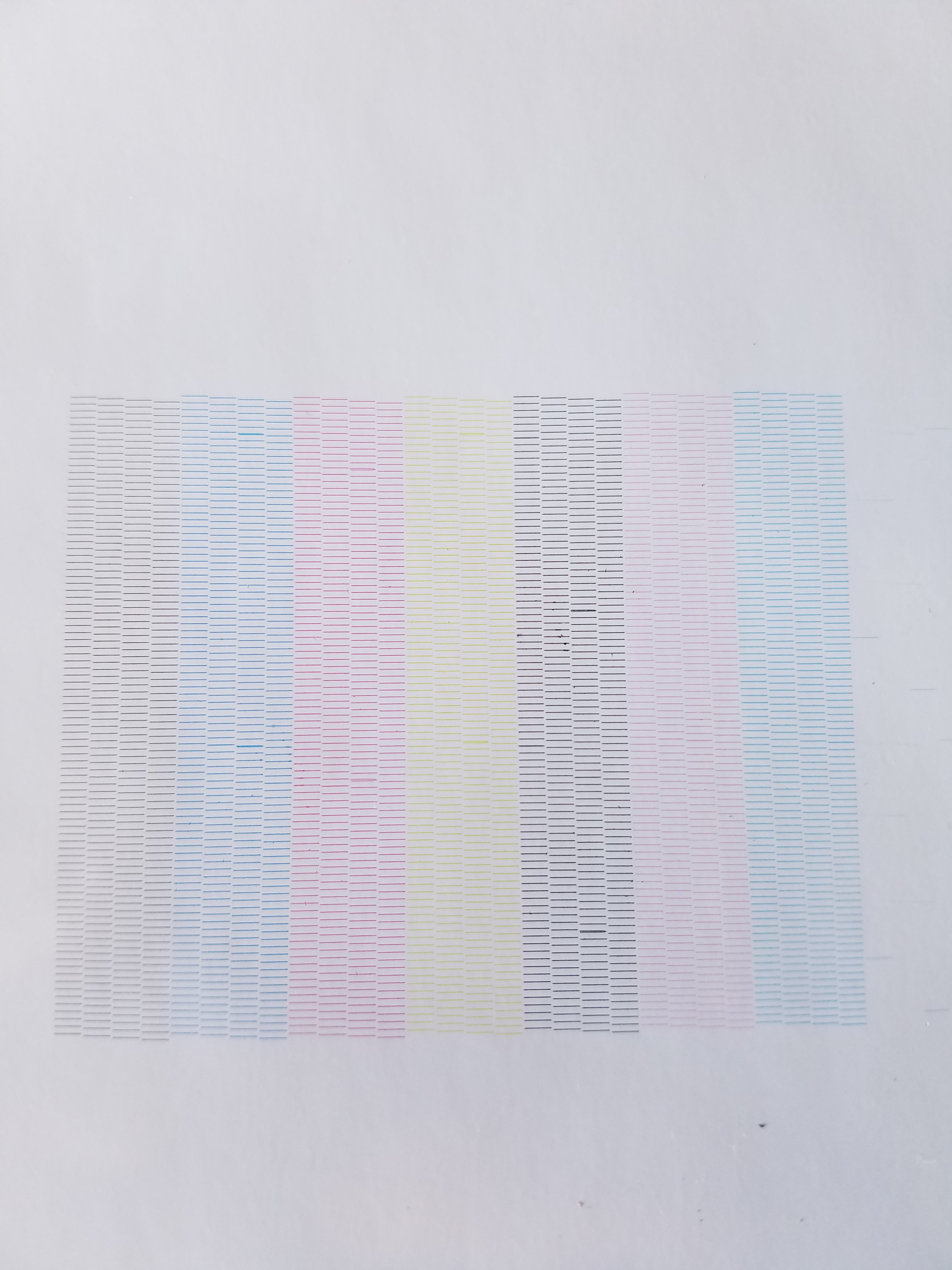

    Thanks , I'm just trying to narrow down a few things to why I can't print a grey gradient , although I have a perfect test print and my new head is just a little over a year old on my VS300i .

    Have you ever been able to? Could it be a profile issue?

    Yeah , when I first got my new print head a year ago I could easily . I've been printing the same files and using the same profile since 2013 . Test print is perfect , this is why I am so confused . Nothing has changed , It's a printer ( vs300i ) I use in my home 1 to 2 hours a day .

    I seen the nozzle check in the other post now, I wouldn’t quite call that perfect! Are those persistent nozzles out? Had any head strikes?

    test-prnt.jpg No head strikes , I posted one yesterday that wasn't the best but I didn't one today and looked great .
